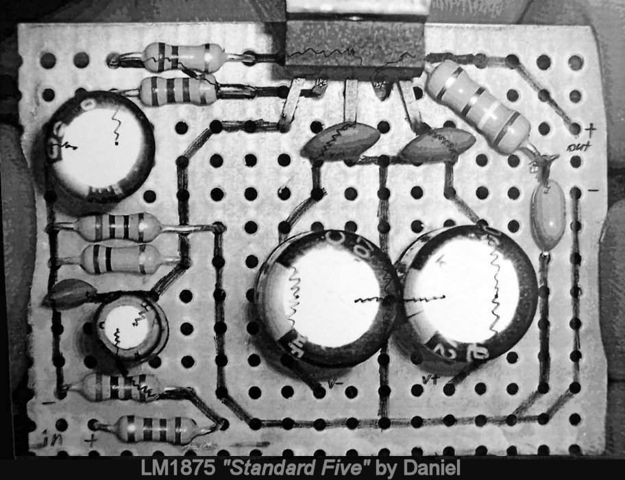

This photo illustrates where the five connections go.
Right side is speaker output with a protection zobel (pitched higher than the audio band)
Center is the power circuit.
The two small ceramic are 100nF (0.1uF, Bar 104).
The two large e-caps pictured are 220uF, although you could use 330uF or 470uF.
Top left is the NFB, Negative Feedback Loop, that is responsible for setting the gain. It is normally two resistors, although the presence of a optional 22uF (or greater) cap there indicates potential for using this particular amplifier without a preamp, as a cap there can prevent the amplifier from amplifying DC (makes zero dc offset).
Center left is shown an optional "ground lift" resistor, as you can see it connecting the ground of both NFB and inputer circuit (input star ground) over to the power ground. It can be 0R, 4R or 10R.
Lower left is the input circuit. There are many options shown.
Going in order from left-center to lowest left. . .
Most important at the input circuit is the resistor from input + to input -, as this presents a load for the source to drive.
Next is the small 330pF (Bar 331) ceramic cap, also a load, as this shunts away stray RF signals.
The ecap is a dc blocking filter, aka input filter cap.
Next is a 1 megaohm resistor set as a load.
Lowest left is a 1k resistor (optional) providing isolation, but also affecting tonality (can use any "pleasant" value there or 0).
See photo and compare to the circuit in the PDF's above.
EDIT: As you can see, this doesn't require a kit.
