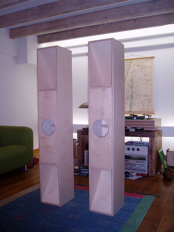

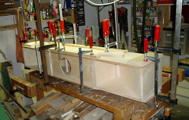

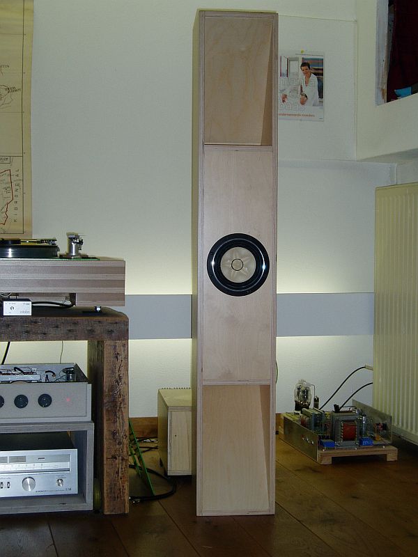

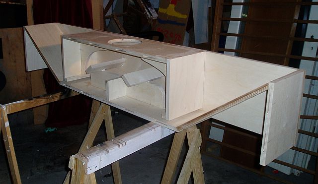

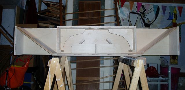

A few month ago I asked Scott and Dave about a Spawn for the Fostex FE168Esigma, in other words a preview of the Ceinwyn. After a few emails I got the numbers that allowed me to draw a cabinet. A small change made it possible to use 1530x1530mm ply because bigger sheets are much more expensive and a lot harder to find overhere. As these things go other things got in the way. But I have finally started to build them now. See pics below.
I have been listening now for a few days and it is a bit of a mixed bag till now. Compared to the Bibs they replace they seem cleaner in the midrange and with a bit more top end. At the same time on things like male voice they sound recessed and not "alive". Bass is very boomy and one note. As a test I have stuffed one of the ports and that seems to help but of course that shouldn't be the way to go.
