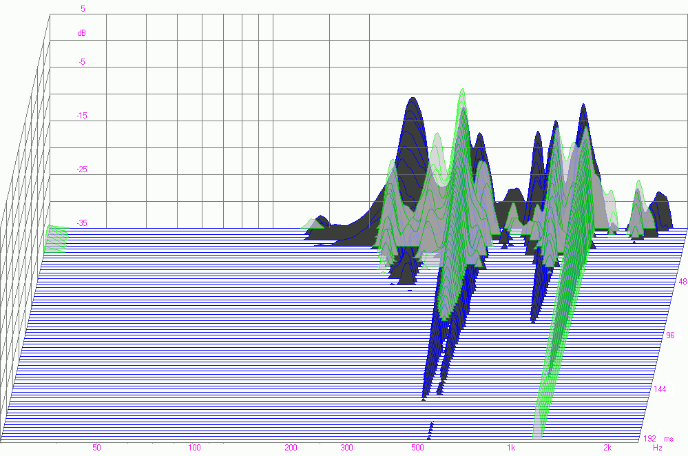

frugal-phile™
Joined 2001
MJL21193 said:
Oh, and here I thought the only real "data" in thread was the results of my testing.
You must have missed the attached real "data" :) LF resonances much worse than HF ones...
MDF is just fine for building speakers. You don't need to feel you have lowered your standards when you use it, as it is just as good, if not better than the other choice's.
I'm sure if you really believed that MDF was better you wouldn't have said this...
MJL21193 said:
I love working with BB, and to be honest, I'm not going to be using MDF anymore. I will use BB and cover that with HDF if I want to paint.
dave
Disabled Account
Joined 2007
Ah, doing some digging.
I will not be using MDF for a few reasons, completely unrelated to it sonic quality. I won't bother going into those reasons here.
The tests I ran tell the story. No mumbo-jumbo. The mic will "hear" a difference, if there is one.
