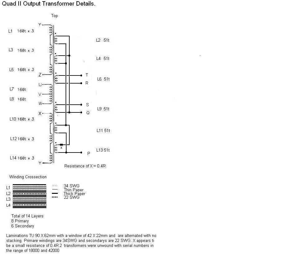

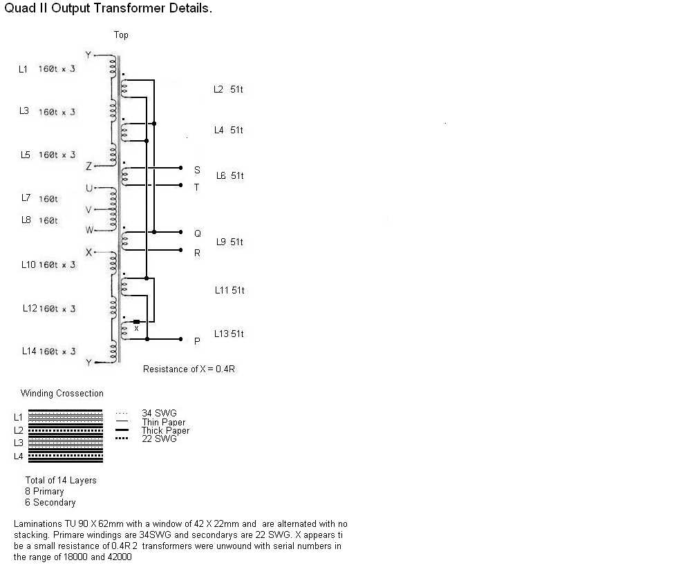

I am in the process of having some Quad II output transformers rewound and have unwound a faulty one and can confirm that the basic arrangement is as shown here
http://www.diyaudio.com/forums/show...ght="Quad+ii+output+transformer"&pagenumber=1
and
http://www.diyaudio.com/forums/attachment.php?s=&postid=844843&stamp=1139868168
(As mentioned later in the post there is no connection between Z-U or W-X)
The laminations are TU and measure 90X62mm with a 42X22 window. They are alternated with no stacking. There are in effect 14 windings, 8 primary and 6 secondary. Each of the primaries consists of 3 layers of 160 turns and each of the seconderies 1 layer of 51 turns.
I don’t have a wire guage to hand but each layer is full, the bobbin is 38mm wide and 160 turns of 34 swg = 0.2337mmX160 = 37.4mm however 51 turns of 24 swg = 0.5588mmX51 = 28.5mm, but 22 swg = 0.7112mmX51 would be 36.3mm which is much closer.
The 3 bottom seconderies are in parallel and the small wirewound device is inserted between the top of the 3rd and 4th windings.
The winding arrangement is p-s-p-s-p-s-p-p-s-p-s-p-s-p. Each of the primary layers as separated by 2 layers of thin paper and the primary and secondary layers are separated by 2 layers of thicker paper. As modern transformers use plastic film between layers how will changing the material affect the transformers performance, is the thickness important and should I have the transformer vacuum impregnated.

Thanks for the advice, I still have some of the layers to be unwound and I shall check the number of turns again, I have 2 transformers, one from about serial number 18000 and the other about 42000, they look identical.
Though they may still be available from Quad they are very expensive, I had some mains transformers wound at a considerable saving and I have listed the extra ones on eBay from time to time with great success.
I shall be in touch with the transformer manufacturer in the next couple of days to see what insulation material is available, would the main difference be caused by the thickness or the dielectric properties
Stuart

I appear to have a problem with my attachment...Stuart
