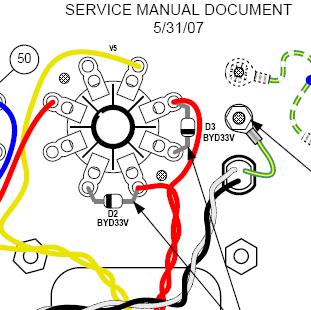

I was just looking over the service manual diagram for the Re-issue 1957 5E3 Deluxe and saw something I do not recall ever seeing before.
A pair of avalanche rectifier diodes inline with the 5Y3 rectifier tube?
BYD33V data sheet
What would be the purpose of these diodes in this location?

Back EMF protection? Bizarre though, as the 5Y3 itself is a diode, but perhaps a pre-emptive strike in case of arcing from a cap further down the line (unlikely or what!! But flashover at >300V can't be nice at any time) and not to fry the trafo?
I found it odd, because the 1950's units of course did not have these, and many are still functioning perfectly after 50+ years.
I have built a few 5E3 amps from kits and from scratch and the only thing I see different is the diodes in the new units.
another noteworthy item would be the original units did not have a standby switch.
On all of the ones I built it is common to get a POP when flipping the standby switch.
On the Re-Issue unit they interrupt the HV CT, I have tried that setup as well as interrupting the B+ lead on pin 8 of the 5Y3, both techniques pop when entering standby unless you put a .05/630V cap across the switch.
Maybe they felt the diode was a cheaper way to protect the PT instead of a fuse?

You have found the reason for the avalanche rated diodes. Some users had FRED diodes short out when flipping the standby switch on the SimpleSE amplifiers. One user had a 5AR4 self destruct. Some glitch capturing with a storage scope revealed some serious transients generated form the collapsing magnetic field in the power transformer. It is transformer dependent, and spikes of over 3KV have been seen on some Hammond transformers. The avalanche rated diodes allow most of the transient to be dissipated before becoming a lightning bolt inside the 5Y3.

I went through several rectifiers before I figured out the arc was coming from opening and closing the CT style standby switch. If you hear an audible pop, Chances are it is or will happen at some point.
On the CT interrupt standby switch I cleared it up by putting a .05/630V film cap across the switch. Knock on wood, after about 9 months of heavy use, no problems.
When I saw the diode solution it seemed like a convenient idea, diodes generally costing a few pennies instead of a $1.00 cap.
Added bonus was you can put them on the 5Y3 socket easily as shown in the picture below.

I just thought I would mention I have been using UF4007 in this same topology for over 10yrs and it is very effective at preventing arc-over in the 5AR4 and other rectifiers with close cathode to plate spacing. I have not had a single rectifier tube failure due to arc over since I started doing this.
Special diodes don't seem to be required for this purpose. I have not had a problem with anything rated at least 1KPIV or above. (1N4007/UF4007, any of the types George mentioned.)
