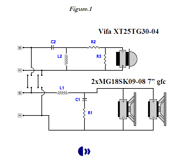

thanks for the input folks. The Vifa midrange is a MG25 7" glass fiber woofer and the tweeter is the XT25. My goal was to clone the lipinski monitors with the time aligned stepped baffle (I figure by aligning the acousitical centers). I was thinking about using some material like whispermat for the stepped tweeter baffle.
So sreten, you say that the Lipinskis are electronically crossed at 4k? I read the article and it said somewhere that it was crossed at 2k? I could be wrong. Anyway my goal as I said earlier was to clone the lipinskis so some low order crossover is in order. steten how would you reccomend I do the crossover?
Once I get the drivers I will test the actual impedance in free air as well as in the cabinet using speaker workshop. I'm also having the tweeter baffle adjustible so that I can adjust for best phase response. The lipinskis also have the tweeter out of phase which leads me to suspect that it uses a 2nd order L-R crossover.

any specific suggestions sreten? I was thinking of starting off somwhwere with a low order butterworth for the tweets and maybe a LR for the midrange. However if the tweeter is phase inverted shouldn't the crossover be a 4th orfer L-R? Once again thans for all your expertise and suggestions.
For the low pass your first issue is baffle step compensation.
A symmetric driver aligned 4th order L/R acoustic response has
the two drivers connected in phase, 2nd order L/R out of phase.
Checkout Zaph's crossovers here : http://www.zaphaudio.com/
Note that most of the crossovers are slightly assymetric to make
up the phase difference betwwen the drivers, except the ZD5
which has a treble delay ladder, they are all acoustic targets.
Specifying an electrical target is fairly meaningless.
Also note the lipinski does not have symmetrical acoustic slopes
at all, but nevertheless seems to work very well in practise.

2-WAY X-Over MG-VIFA L-Pad
You have here a good base to work on...
