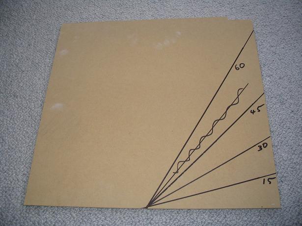

For off axis measurements I just use a piece of MDF marked with angles as shown. Speaker cannot move or possibly vibrate like it can on a pivot. However, you might get some small reflective artifatcs from the board itself and it can be prone to tipping the speaker.
I am lucky in that I live in a quiet street with a 4 metre (13 foot) balcony. I reckon I can get a 17+ msec gate for a 3 way design pending. I will place the mic on a boom extending out from the balcony - pref. 2+ metres to get point summation of all 3 drivers. For off-axis measurements, the mic will stay put and I will tilt the speaker (placing horizontal) using shims to effect the angles.
