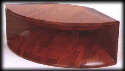

This is Yuichi's homepage, http://home.aol.com/araiyuichi/ and I've added a pic of the A290 below.

Note: this is a pic from Yuichi's page. My woodworking abilities are not that good. Mine are from 6 layers of 30mm mdf and a ton of resin. They weigh about 25kg + driver, and are 650mm x 400mm x 300mm (wdh)
Mr. Yuichi
Mr. Yuichi...... yes, I do know his work; just did not make the mental connection. I've seen his speaker work, over the years in MJ magazine; and his photography in a studio in Old Scottsdale, Arizona.
