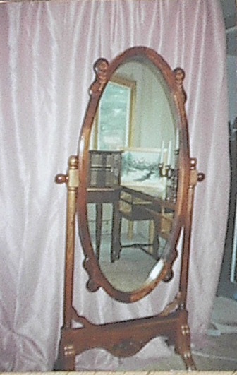

Hi Roman,
I went through my shellac period long ago. Can't say I "mastered" the French polish, but I got reasonably good at it and put it to good use on all of the stuff I used to produce, such as this:
Low quality 20 year old photo.

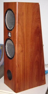

This is a reply more for Brett who asked about satin finish than Cyberspyder.
I veneered a pair of floorstanders a couple of years ago with jarah (an Australian hardwood with lovely mixed red colours). I like the look of an oilfinish but this would not have been practical (fades, picks up dust, shows drink rings etc.) so I finished them in three coats of matt estapol clear single pack polyurethane with a really light sand between coats
http://www.wattyl.com.au/DIY/Products/ProductSearch/Product_Details.htm?Id=454
They came up a treat. Really look like they are oiled. The other great advantage with a matt finish is that it does not show up the imperfections in the surface. After a year or so some very small bumps came up where I had filled over the screws. Very hard to see unless the light is just right.....if I had used a gloss finish they'd stick out like the proverbial dogs....****'*.
Brett, buy a small can and try it on a bit of scrap....

Brett....here are a couple of shots to give you the idea.....taken a couple of years ago unfortunately with a flash....the flash makes the finish look glossier than it really is. In natural light or with the normal room light, they appear oiled. If you do try it on a bit of scrap, make sure you give it at least two coats.....the first one pretty much disappears into the timber as a filler coat. Another thing I like about it is that although the matt finish makes it look like the surface is porus, the three coats of estapol is really substantial and everything just wipes off it.
