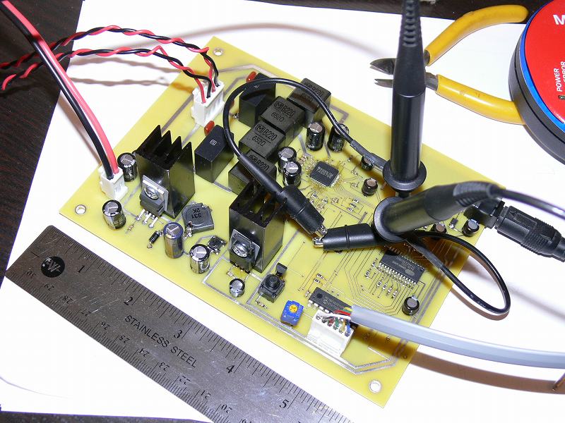

TAS5706 simple full digital stereo amplifier
Now TAS5706 amplifier is playing great music from small board 🙂
I think TAS5706 can be final solution for Stereo Full digital Amplifier for DIY.
please see my website for detail, and hi res photos.
If anyone want to be group by manager, I can provide ExpressPCB CAD data. ( I don't want to be.. )

Wow you're working hard on this! Impressive!
A question; does using SMD components provide advantages concerning RF? I'd assume that with a low density PCB like this it would have been possible to make use of larger sized resistors, which would make it a bit more accessible for DIY'ers?
Wouldn't it make sense to add more ground plane areas on the top side of the PCB, in addition to the bottom?
Also, what kind of power supply would you recommend? A 12v STEPS setup? What's the maximum current draw?

This is made by ExpressPCB, I'm not etching for these years. (messy chemical, drilling...)

does using SMD components provide advantages?
more ground plane areas on the top side of the PCB?
Soldering 0805 is not difficult, and it can provide small footprint / without hall, wireing freedom / cheaper / small storage in my desk.
ground plane on the top works nice at 4 layer board, but small meaning for 2 layer.
Power supply can be 12V, from generic wall adapter to Lab DC power, maximum about 2A. Or you can use Battery, Or if you need more power, you can supply up to 24V.
I'm using small DC Lab power supply, spec 18V/3A. for desktop usage, TAS5706 uses 11V / 100mA.
iampivot said:
Can your design take 18v regulated in order to deliver the maximum 20w output?
Yes that's why 5V regulator is switching. no overheating by high supply voltage. you need heat sink for high power.

Hi I tested now,
(a) single channel, TAS-4i (TAS5518+TAS5142)
(b) TAS5706
... and I'm not sure I can pass blindfolded test. TAS5706 is worthy adversary with LINN Acurate212.
(a) pros: Power supply voltage control.
(b) pros: closed loop. newer design?
TAS5706 board has external I2S input, so if I have time I can try something other than CS8416.

Hi thanks for interest,
TAS5706 does not require variable voltage, it takes 10-26V range fixed. Now I'm using $199 Lab DC supply, 18V/3A, as 12V ps.
I will try to connect I2S later, from my SD card player, and USB I2S device. ...By my SD card player, I can try whole DIY full digital, no AC, no motor audio system🙂
For group buy,, just a while until I order box & satisfied for inspection. I have 2 boards so I can send 1 to someone.
