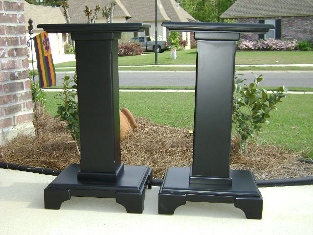

Finishing my speaker stands was wonderful. I can have my garage back for parking autos. This project was not without its issues and the project did bring up some what ifs. Like I wish I would have included the sub woofers into this stand.

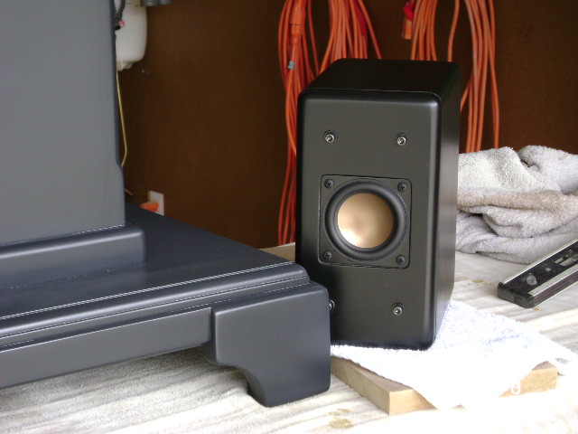

I originally painted one of these stands with kilz black satin and it did not look good so I had to resand and paint with rustoleum satin black. Notice the color of the rustoleum satin black diy b3s next to the kilz satin black stands.

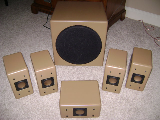

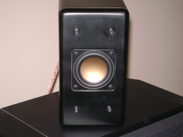

Im not sure if youve seen my 5.1 system I built for my home gym but Ill include a picture.
My next project will be a small entertainment center for the gym (nutmeg) and a credenza type piece (black) for my bed room.
These pieces will be made of solid ash.
I would like to match the nutmed paint with some stain for the small entertainment center. I tried to make my own stain by spraying a can of paint into a container and adding mineral spirits to thin then applied to the ash then wipe off but that did not work.

Any one else interested in building a pair of these fear not they were no harder than building a set of speakers.

Is that surround setup the one featured on Partsexpress ?
Looks very nice BTW.
I have not made many of my own stains, but I did have good luck with mineral spirits and artist acrylics. It may be worth a small experiment or two.
7/10 (born and bred in EBR)
Nah John "Zaph" Krutke designed these B3S speakers http://www.zaphaudio.com/audio-speaker18.html.
The sub is a dayton 10" dvc http://www.partsexpress.com/pe/showdetl.cfm?&Partnumber=295-485 and the sub amp is a 100watt dayton http://www.partsexpress.com/pe/showdetl.cfm?&Partnumber=300-802. This set up is nice for a small room.

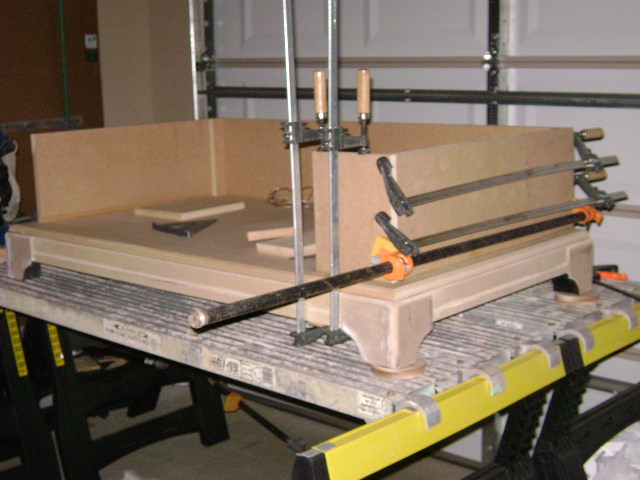

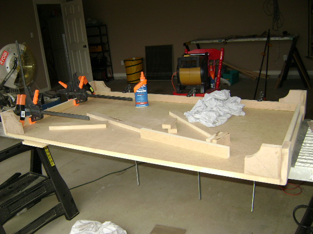

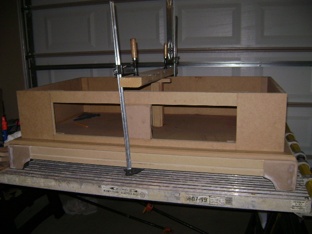

Im building a credenza to match these speaker stands. This piece will support my 48" projection tv. I had to have it raised 1'4" so I could use the tv in my bed room. Long story tv swapping at its finest. I am building this piece out of mdf to keep cost down because it will be a throw away after the tv fails. What use would a 1' 4" credenza have besides what Im using it for.

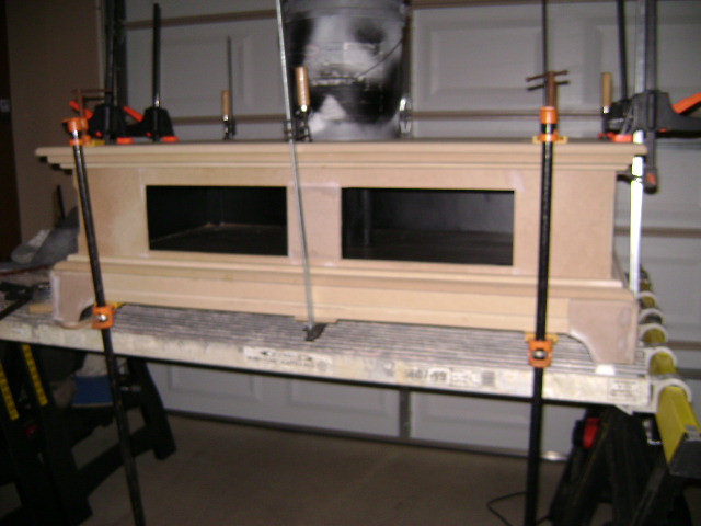

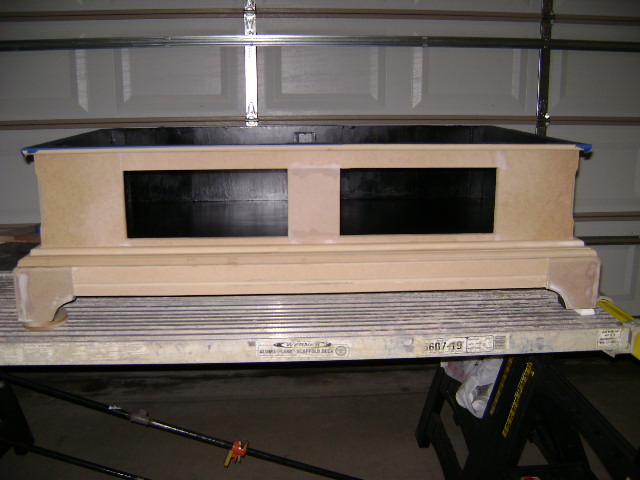

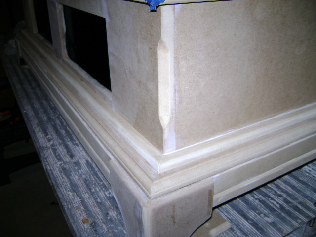

Slow going today. I wrestled with the router I have on my router table. The motor screws vibrated loose. A bit got stuck into the chuck and the router table hole was to small for the round over bit I wanted to use so I tried to dremmel it bigger. That turned into a hassle all in itself.
I managed to put on my trim work and prime the inside of the credenza. This thing is really getting to be heavy. Hope I can lift it after Im finished adding mdf.

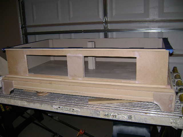

Hitting the edges like this really dresses the corners up.
I still have a sub woofer to diy for this project. I was going to just build it into the cedenza but the vibration would prolly have messed up my projection tv.

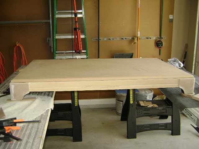

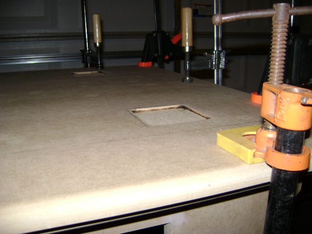

I finally get to glue the top onto this credenza. Notice that I recessed the top to accommodate the wheels on the projection tv that will go on this piece. Last thing I need is the tv to roll off of it after I went to all this trouble.

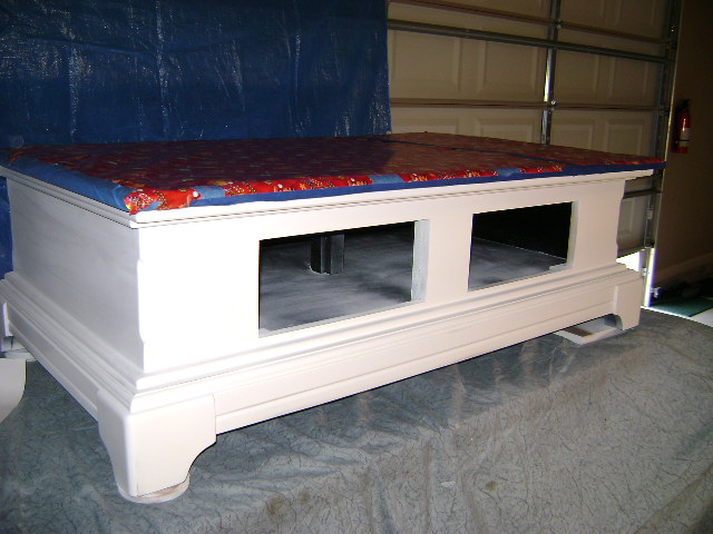

I finished my sealer coats. I sprayed on two coats of Kilz then I sanded piece smooth. I then sprayed one more coat of Kilz. I will spray three coats of rustoleum primer then sand smooth again. That spray can handle is a life saver on my button finger.

OK Im through sanding primer. There is point where you have to say its good enough. Id be here till christmas sanding if I wanted it perfect. Speaking of christmas I managed to bring a little xmas cheer to my day. I ran out of brown paper and had to resort to my wrapping paper stock. Guess I shouldnt have grabbed the disney paper. To late.
