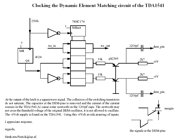

Anyone successfully implemented the Henk ten Pierick DEM reclocking for the TDA1541 ?
I've tried, but I can't get it working. Get noise & distortion, guess the active divider isn't working.
I'm using 4*fs (non-oversampling application),
and BC557B's for the PNP's
The negative voltage is -6.1V
I measured -10V DC voltage on pins 16 & 17.
The FF indeed has the 4fs signal on it's outputs and there is some sawtooth on the DEM pins (noisy), but no luck.
Anyone ?

It's in a cd player, so I do have the 11MHz.
As I menioned, the divider and FF work ok,
I have the 4*Fs square waves on the FF outputs.
In fact I have tried 8*Fs as well.
If you're interested I send you some scope shots of what I'm seeing.
The original DEM with capacitor:
Measuring a pin to ground shows a sawtooth; there is a phase difference between the two pins resulting in a triangular signal when measuring between the two pins of +/-0.5Vac @ -10Vdc
With the DEM reclock circuit:
Measuring a pin to ground shows something like a sawtooth; like the inverse of the signal that is shown in the picture. But there is a lot of "noise" like small oscillation superimposed that signal.
Also the AC value is at least halved.
I've also tried with 2.2k and 3.9k in stead of the 2.7k
With higher resistors, the ac value goes up in amplitude, but the sawtooth ramp rate stays the same, resulting in a bigger "step" when the other transistor is switches.

Exactly where can one find info on this
DEM reclocking? I.E., where does Mr.
Pierick have it posted?
DEM Reclocking
Hi ,
I don't think Henk ten Pierick has posted his scheme on a forum or website. Best contact him directly by email.😎
His emailaddress is in the picture of the schematic. (leftunder)🙂
Hi ,

I'm trying to implement DEM reclocking as well. I have one question on the schematic which I hope the guys who have implemented the DEM reclocking successfully can share their thoughts on.
Is there any purpose to connecting pins 3 & 4 (D0 & D1 for ws_in) and pins 2 & 5 (Q0 &Q1 for ws_out) together? It would appear to me that ws_out is now a 10V clock whose voltage is double (due to the summation of Q0 & Q1) that of the normal ws clock. Wouldn't this have any adverse effect on the TDA1541A chip?
If there's really no purspose to the above, why not just use D0 for ws_in with its corresponding Q0 for ws_out only. For those thinking of reclocking BCK as well, just use D1 with its corresponding Q1 to do so.
I sent an email to Mr. Henk Ten Pierick but have yet to receive words from him. Anyway, I thought it may benefit all to have the discussion on DEM relocking here on the forum.

My implementation of the DEM relocking is finally working and it complement my tda1541-based non-os dac (which I also recently completed, I will post a new thread on my DAC soon 🙂 ) very well. Mr Henk Ten Pierick has kindly replied me on the questions I raised in my previous post. below are his comments:
"The output signals at Q0 and Q1 are the same because their inputs are also connected together. The output voltage of Q0 and Q1 is the same, therefore the outputs can be connected to each other and is equal to the supply voltage of the latch. The parallel connection does not influence the output voltage but doubles the available output -current-, there is more drive current. This is beneficial because we want to drive the pnp transistors."
my implementation differs slighly from the original schematic - 1) I'm reclocking bck instead of ws. 2) the divided freq is derived from Q5 of 4024 (4*Fs) instead of Q4.
Right now, I just want to sit back and "rediscover" music. When I get around to doing some more mod, I intend to try out the following:
1) replace 74hc4024 with 74vhc4040 (dont think there's a vhc version of 4024) - to reduce propagation delay of divided freq.
2) replace 74hc04 with 74vhc04. reason as above.
3) replace 74hc174 with 74vhc374 and reclock all 3 lines (data, bck & ws) together with the required current drive for the pnp transistors.
4) try 8*Fs for non-os application?

Quick question... I am looking to implement this DEM reclocking circuit. The diagram at the start of this thread indicates a ph2369 transistor. This is an NPN transistor, not a PNP as indicated on the diagram.
Could someone confirm this, and suggest a suitable PNP to use?

Re: PH2369??
I just used generic PNP's like BC557B
Did you compare 4* against 8* DEM reclocking moemoe ?moemoe said:Hi All,
This is a typo on Henk's schematic.Zodiac said:The diagram at the start of this thread indicates a ph2369 transistor. This is an NPN transistor, not a PNP as indicated on the diagram.

After some mails with Henk about why he reclocked WS, the conclusion is (with an I2S player, e.g. the 960):
Reclocking of BCK is most important (in and output latches are clocked on BCK) and reclocking WS and DATA is beneficial too.
Reclocking of the DEM clock before the transistors is done for removing jitter introduced with the 4024.

Now looking at the logic used.
A standard 4024 is slow, so you need to invert the clock of the '174. Otherwise the '174 would be clocking in and the 4024 hasn't clocked out yet....
delay of the 4024 is 50/60 nSec. 11.2896MHz is 88nSec, so 44nSec between clock high to low and low to high. With the
inverter you get 88nSec+inverter delay for the 4024 to output the data instead of 44nSec which is not enough.
So don't use a superfast 4024, say with a delaytime which matches the inverters delaytime. The 4024 would be clocking out while the '174 is clocking in...
And the '174 needs some time that the data needs to be stable before clocking.
Faster logic isn't always better
Or if you use a superfast 4024 you could remove the inverter in the clockline of the '174. The 4024 then has 44nSec minus the '174 setuptime for dataoutput.
Fmax of a 4024 is typical 10MHz at 5V, that is less then 11.2896
And minimal is only 5MHz
(looking at philips datasheet of standard CMOS HEF familiy).
Anyone looked at this? Which logic are you using?

Hi Guido,
Re the logic question...If you use syncronous dividers such as the 74HC163 then delay becomes much less of an issue compared to binary counters like the 4024 / 4040. I am using these without an inverter on the clock line to the flip flop.
Rgds.
Rgds.

Thanks,
You have confirmed my thoughts. I'm going to look what i can get easiest/cheapest on logic. Wanna try and find a FF with inverting output (like '74) so i can do without inverter all together. But maybe i'll put it together the way Henk did. As long as i understand what is going on 😀 mmm sortof
