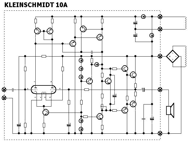

What kind of interest would there be out there for a very simple, but good performing 10W class A (into 8 ohms) rated power amplifier:
a) specifically designed to be build as a monoblock.
b) TO-3 complementary BJT output.
c) Of the single polarity supply / capacitively coupled load topology with the esoteric twist of having a common as muck 12AX7 twin triode in the front end.
d) Specifically designed to be built from non-esoteric, cheap, universally available parts.
e) All components (bar the two transformers and one bridge rectifier) PCB mounted for ultra-easy assembly.
I have design I made quite a while ago and considering the popularity of the JHL class A, I’m seriously considering publishing it and having a batch of boards manufactured (to be sold for profit in fame only)
Specifications are not subject to negotiation, and no audiophool blowhard arguments about the evils of coupling capacitors and mixing SS with toobs, thanks.

Hmmmmm....... the TO-3 package will still be with us for some time to come and some of the cheapest and most robust trannies for this application come in T0-3.
If some newbie builds this class A thingie and cranks the bias up too high the first time round, or does a test run on inadequate heatsinks, a pair of TO-3's could be a blessing (especially over TO-220's).

10W class A still gives ~30W idle dissipation. The bias can also be cranked up for 20W into 4 ohms - then we have closer to 55W idle bias.
And sure I can specify the correct heatsink, but that doesn't increase the designs dummy proofness.

Have you done any simulation? What B+ for 12ax7? I like the design. 😎

Do you have any specs for this circuit, such as PSRR, input/ouput impedance, THD, damping factor, slew rate, etc.
thanks
OK, here's the deal. I'll have a small batch of boards made up. The prototype was a rats nest perfboard thingie, so before the design gets released in all its glory (component values / PCB layout revealed), I'll build up the working units that I want for myself on the new boards and thoroughly test it first.
I’ll then put the whole design up on the net on a dedicated web page.
The schematic will be revealed for anyone who wants to roll their own, but I won’t release the gerber / Protel files for the PCB until I’ve sold off the surplus ones.
Plate voltage for the 12AX7 is ~100V. Both transformers have a 24V secondary. Transformers with 24V secondaries or dual 12V secondaries than can be series connected are readily available.
I used a little off the shelf 150mA unit for the top (on the schematic) transformer and a cheap 2.5A (60VA) unit for the other.
I have also decided on a minor alteration to the PCB. As well as the transformers and the power rail bridge rectifier, I have decided to redesign for the main 10,000uF filter capacitor to be mounted off board also. Most potential builders would have a collection of salvaged caps, some chassis mount, snap in, etc, so this will save having to specifically order a unit to fit the PCB.
Performance specs are pretty much in line with the Silicon Chip and D.Self class-A designs.
