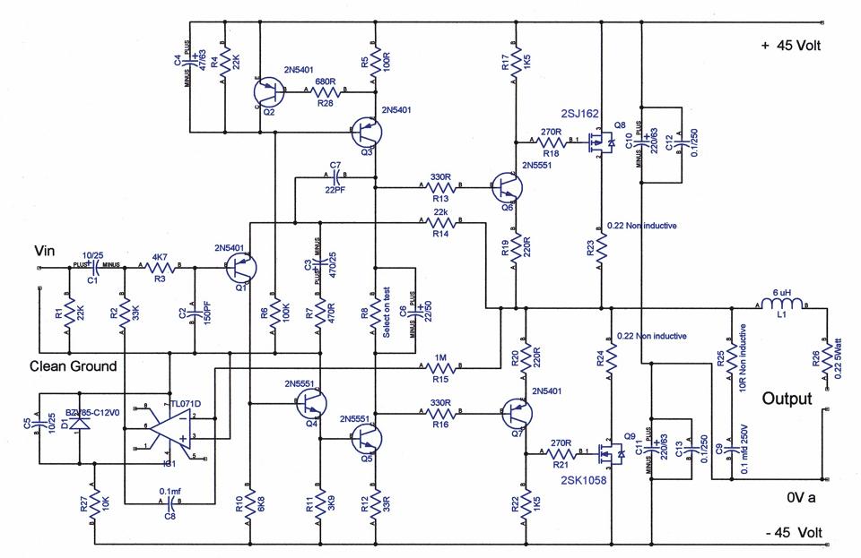

Hi, Well after having seen all the amazing projects and designs you guys have come up with I thought I would share my design on these pages. First and foremost this was designed for music reproduction in a domestic setting and without wanting to "hijack" another current thread, YES amplifiers do sound different, that is why I spent so much time in the development of this one. This amp is without doubt "musical" in all the best sense of that term, it's ability to recreate a believable soundstage is absolutely compelling. If anyone is interested in what it looks like and further details there are some pictures in the "Post your solid state pics here" forum. (About post 283) The thinking behind this project draws on the work of the late John Linsley Hood whose designs and thinking I much admired.

1. The circuit diagram in this, post #1 is correct. The only omission is a 10 ohm 2 watt carbon/metal film across the output coil.
2. The TL071 opamp must not be substituted. This type works correctly on the single negative 12 volt rail. Other device types may not do so.
3. A speaker relay incorporating a switch on delay is essential due to the action of the servo and the single ended input stage. This can be extremely simple consisting of a FET, a C-R network and relay. Post #273 in another thread shows the idea of solid state relays developed into a working example. Credit for the idea of the SS relay goes to those mentioned in that thread.

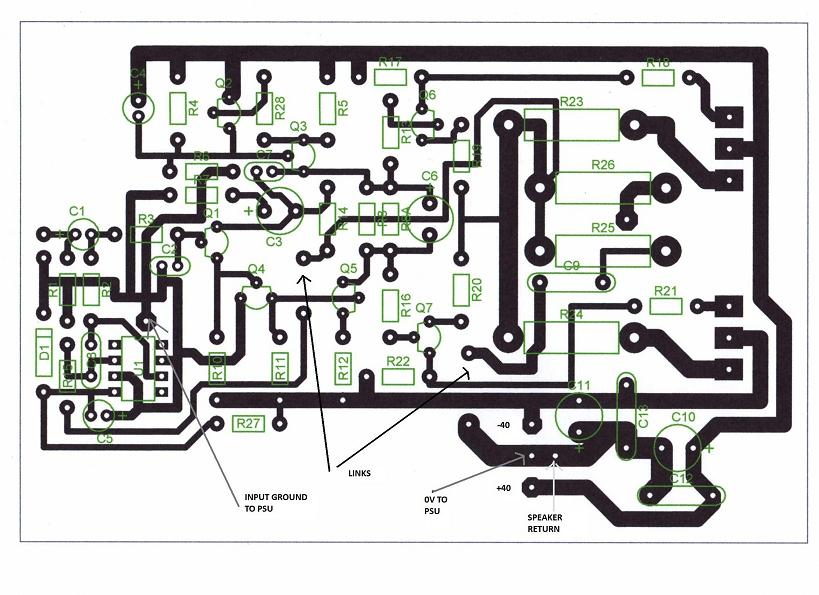

4. alex mm' brilliant PCB designs. Post #300
My MOSFET amplifier designed for music. - Page 15 - diyAudio

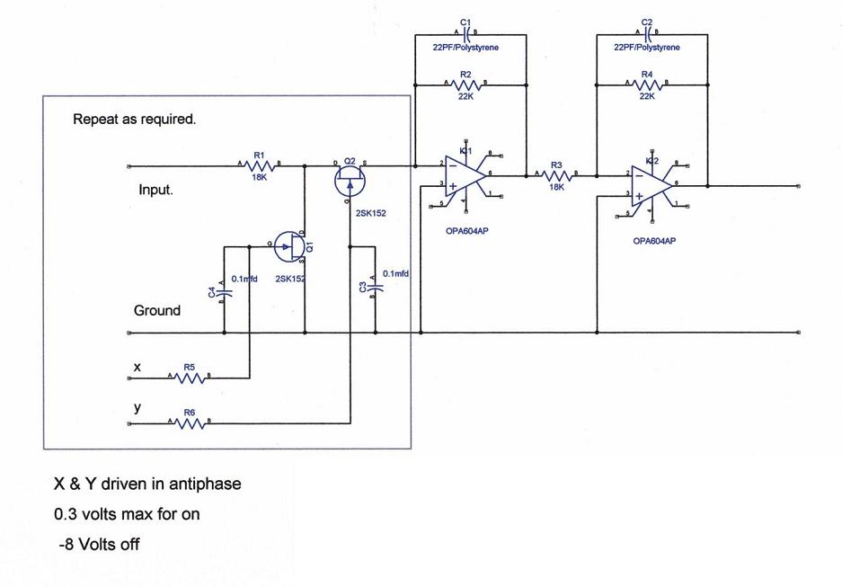

This is the Preamp in outline form (I am only just getting to grips with a PCB Software package) all the original work was hand drawn. The series /shunt switching works brilliantly and give total isolation between inputs. Even with something ridiculous like a 10volt peak/peak squarewave as an input, there is no audible breakthrough even with volume on max.
darkfenriz said:
... and C3
Hi Darkfenriz, how are you? 🙂
I agree , the servo is "in charge" of taking care of the offset...
Anyway, C3 in the schematic is with the polarity inverted... 😉
Hi Tube_Dude, you know, I wondered that at the time, my reason for including them was to provide more? if thats the right word isolation for the MOSFET's . They do reduce efficiency though. I would like to develop this design further, possibly running the front end (Up to Q3 and Q5) on a higher rail with shunt regulation (Power supply rejection is one area that could be improved).
Darkfenriz, wish I could do away with the electrolytic in the feedback arm, as you say the servo is in charge, but the base voltage of Q1 is around -6volts, so C3 is unfortunately needed (polarity is correct on circuit with about 5 volts across it) . That's the price you pay for using a single ended input stage but one that's well worth it. The TL071 works fine with only a single negative rail in this application, many other Op-Amps won't and would need + & - supply.
Thanks for the input
Karl

Molly
the -6V on Q1 base will go up closer to zero if you remove the capacitor, like -1.5V or so...

Hi, I don't think to be honest it's quite that easy, (oh by the way whose Molly 😉 ) the operating point of Q1 would be shifted away from it's linear region. With higher values of R7 what you suggest would work, but as R7 is reduced, decreasing the global feedback, the servo would not compensate. Think of an "old" A.C. coupled design on a single rail with a pot to set the "mid point" voltage of the output transistors. If you shorted the equivalent cap in an amp like this you could never readjust the midpoint to compensate. This design more closely resembles this configuration. Thanks for you're interest, I think even some of the "Tube" fans out there would be suprised how musically engaging this amp is.
Thanks again Karl

Hi Mike, The original P.C.B.'s were all hand-drawn one offs unfortunately. Now P.C.B. layout is another subject on it's own, and layout and correct grounding is vital to get the best performance. I will say this though, designs like this are far more "docile" to work with than many of the more complex (I am thinking of what are really discrete power opamps here). I can't help but feel this stability is one reason why it does sound so good. When making a stereo amp with a single P.S.U. I could never quite "get my head around" the best or ideal grounding configuration. The problem is that while it is easy for one amp(channel) with one P.S.U. I could never reconcile what happens when the two signal grounds (Left and right) are connected together at the input which at some point they must. I know there are various techniques used e.g. a "ground lift resistor" to overcome these problems but I was not happy with any. In the end I actually built a model consisting of two OpAmps on two P.C.B.'s which represent the two channels. I used 10 ohm resistors in the ground leads to highlight and get a feel for what really happens when each channel is supplying a different signal to there respective load. Doing this I came up with a scheme that eliminates as much as possible any interaction.
Regards Karl

Hi Mooly
I had a friend of mine have a look at your schematic and he made some nice comments which I thought you might like to read. They are as follows ...
🙂nice design!
Yes this is indeed a sort of Linsley Hood breed.
I built one of his famous amps designed back in 1969, a 10 W class A amp with very transparent sound sonics.
This Mooly Amp draws from the tight grip on the non-linearities of the output stage, keeping them under control by heavy local NFB. The non-linearities usually account for the spectral spray of THD and IM signals. So, keeping them well under control makes the amp sound rather nice.
The input stage is quite a bit outdated and a true copy of Hood's design, added a servo loop to get rid of the Vbe offset.
Hello KLe,
Thank you for posting your friends thought's on my design-- you must thank them from me. " The Mooly Amp " wonder what that would look like silk screened on the front --- that could be the next big seller 😀
The amp though in all seriousness, it's not just good sonically, it's absolutely marvellous, better than anyone would expect from a quick look at the circuit. THE MUSIC LIVES. No other words to describe it. Someone PLEASE PLEASE build it and shout to the world how good it sounds.
Karl
Karl
Hi MoolyMooly said:... The amp though in all seriousness, it's not just good sonically, it's absolutely marvellous, better than anyone would expect from a quick look at the circuit. THE MUSIC LIVES. No other words to describe it. Someone PLEASE PLEASE build it and shout to the world how good it sounds.

Erm-- A few have asked this 🙂 . As I have said earlier the originals were one off's in the truest sense-- have a look at the pics I mentioned at the start.
The best I can offer I am afraid is an untested layout-- which was really an exercise in using DipTrace for me. Having said that the whole design is extremely stable and not prone to any "nasties" and even on prototyping board it performs well, and I can not see any major problems with using this layout.

Mooly,
it`s easy, isn`t it...just to follow the successful path of great sounding English topologies.
Did you experience oscillations in the output? How did you determine R13/18?
