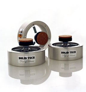

Hi gurus,
Does anyone know how to make feet for a chassis which are audio isolating? I am thinking of the Solid Tech brand.
I am trying to source some thick anodized aluminium tubing, then I thought I could use a tube cutter for nice cuts; though I don't have access to a machine shop, the final finish especially on the edges would be difficult.
Three small springs drilled to the inner rim, and finally a small foot on the inside as seen in the photo.
Or maybe someone knows of a source for said feet but without a heavy price tag...

Good idea in principle.
Except
There will still be contact and friction between the magnets and each leg.
So there will still be noise & vibration transmission.
Andy
You could, of course, eclose the 'fixed' and 'chassis' magnets within, say, a foam tube, which would serve to keep them aligned without transmitting any significant (HF) vibration. The weight would of course be carried by the repulsive force.
(Not that I know why any of this might be necessary, but...)
Yes, even if you used some more magnets, so the telescoping tubes wouldn't even touch each other, there would still be transmission of motion from the base.
And, in fact, it might be almost a worst-case for airborne pressure waves affecting the motion of the 'suspended' unit. Spring suspensions would suffer similarly. There would also be some nasty resonant modes, in either case.
The solution would appear to be adding damping (like small 'shock absorber' cylinders, or just the right amount of friction), and maybe some mass. Additional damping would also be needed for both horizontal modes. Sounds 'messy'. But the filter equations would be straightforward.
Either that or create an active-feedback motion-cancelation mechanical-stabilization system. That might be a fun project, using some MEMS accelerometers, and maybe some speaker motors as actuators, plus some feedback-control amplifier systems.
Any type of vertically-oriented 'suspension' system seems like it would create many more problems than it would solve, if it solved any at all.
And it seems much simpler, and probably much better as well, to just use a very massive base, to rest the unit on, or to which to firmly attach it, unless you need protection during earthquakes as well.
