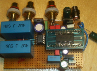

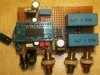

I made my first DAC on breadboard and it don't work.

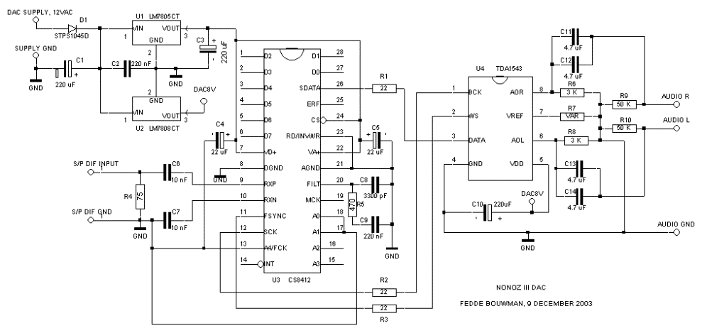

I made few changes, compared to attached schematic. I use CS8414, instead CS8412, with 2 x LM7805, one for digital part and one for analog. And i have simple wires in 22 ohm resistors place.
I try it with cheap DVD, in settings I try both SPDIF/PCM and SPDIF/RAW, no audio output in both.
I check all voltages on all power pins are correct, on AOR and AOL is about 5V, on VREF 2V, on BCK 4.9V, on WS sometimes 0, sometimes 2-3V, on DATA 0V. I disconnect 3 wires from CS to DAC and turn in, on all 3 DAC input pins - 1.2V, on CS output 0.
wen DAC is on some time, LM7808 and DAC chip are litle warm, 5V regulators is cold.

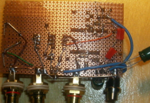

I check all solderings few times, all is correct. What can I check more?
Are CS8414 different from 8412?
Are 22ohm important? I see somewhere schem without it.
Maybe DVD have not digital signal at output?

Picture would help.
I made a TDA1543 DAC this week with Twisted Pear receiver and DAC on separate board. It did not work at first as there was no connection between the DAC ground and receiver ground as I used two supplies. After connecting the grounds I had music.
But again..... picture would help.

jayang727, I think all grounding is correct. I use 12V regulated PS, on pins 7, 22 and 24 I have 5V on DAC's pin 5 - 8V.
I check all voltages and ground on pins 8, 13, 17, 18, 21 and 23 before installing chips in sockets.

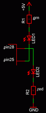

Zigis said:
rfbrw, any link to this "idi0t light"? Are I understand right, it show me, are digital signal on DVD player or not.
BTW, which settings I need in DVD - spdif/pcm or spdif/raw ?
Are there way to now, are on receiver output signal - where is error, in CS or in DAC.
The CS8412/4 has two pins that go high in the event of an error. Pin 25, ERF will go high when there is an error. Pin 28 VERF will also go high in the event of an error but as it is logically OR'ed with the validity bit it will also go high if the data is not LPCM, i.e. AC3 data or MP3 data.

Thanks, rfbrw, for the schematic, I made it, red LED work (28 to ground), green not work (25 to +5) all the way.
Archwn, do you mean pins 1-6 ?
I have 0V on pin 1 and +5V on pins 2, 3, 4, 5, 6, 24, 25, 27, 28.

I found one error, pins 13 and 14 was short on adapter.
I fix it, now on 27 is 0 (+5 before)`, on 4,5,6- 5V all way, on 2 and 3 sometime 0, sometime +5
I have adapter on socket, maybe I can try to resolder adapter direct to board yesterday.

Forget about pins 1 to 6. Unless you are using a 6.144MHz reference signal on the FCK input and are then able to decode the resulting data or have a thorough understanding of the use of subcode in the IEC60958 standard, they will mean nothing to you. Pins 25 and 28 will tell you all you need to know.
