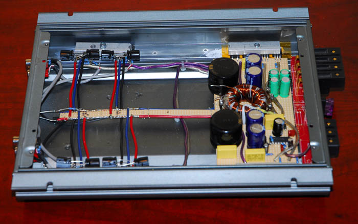

here's a picture of the amp.
At the moment I'm running all four channels off of one set of rca's and everything is perfect, it's only when two sets of rca's are used the noise is there(there's also the posibility of the 2nd rca being bad, I'll have to test that)
as you can see each "pair" front and rear have their own signal star ground, could that be part of the problem? This was done to keep the layout clean and easy to setup.
And MartyM the output ground of the smps is completely isolated from the cars ground. From what I can tel the ground loop is between the head unit and amp, and the ground difference is caused by the two ground paths of the two types of rca cables. But how do I fix it?

Well, basically assuming "all is well" in the amplifier I would start using trial and error to eliminate the source.
Note: I'm not quite sure I understand how you mean exactly regarding the star grounds of the RCA connections in the amp. But anyway...
I would start with eliminating the ground of the head unit to chassis and instead connect that (with a decent sized wire) directly to the ground terminal of the amplifier and eliminate one variable.
Then when everything is turned on, start using small wire with bare ends to connect the RCA shields to (1st pair to second pair) each other, then RCA sheilds to amp ground terminal, then to the head unit chassis, then etc...
In my experience usually you'll end up (eventually, though not easy) find what general conductor is carrying the ground loop.
what happened when you measured continuity from the RCA shield conductors to chassis ground for both front/rear RCAs?
And, have you tried usually only one pair of RCAs at a time, but connect those to all 4 inputs to the amp using Y cables in order to see if it happens?

Hey MartyM thanks for the reply.
At the moment I have all 4 channels running off one set of rca's (instead of using Y adapters I just desoldered/resoldered where the rear channels get their signal from) with all 4 channels getting signal from the front rca's there is no noise at all.
And before when i used one rca cable on either the front or rear channels there was no noise.
I will have to try your wire idea though and see if I can track down exactly where the noise is coming from, as well as regrounding the head unit at the amp.

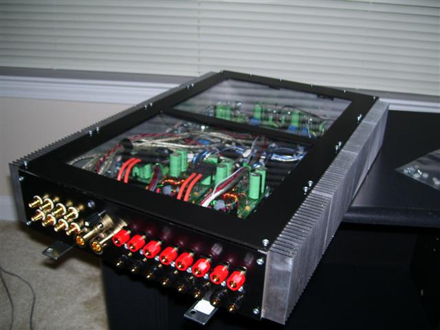

At any rate here's my first car amp project, almost finished:
Marty

Hi MartyM that amp looks good, the casing must have taken awhile, looks like you built it from scratch. I have a few dead amps laying around so it was easiest to gut them and use a few of the good parts in my amp (ie power/ground/speaker terminals the toroid and some caps) I'd like to see more pictures of your amp and the rough design. I should have some time tonight to do some playing so I'll try the ideas that have been posted. I really need to get this running off seperate rca's because using the time alignment right now just destroys the sound stage because it controls ALL left/right speakers with the front outs.
