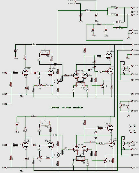

Hello Tubelab,
Just curious: could you post or pm the schematic of your 6336A -SE? Could not find it on your site.
Best, Arjen.
Best, Arjen.

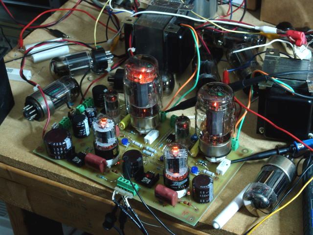

The amplifier was one of my augmented cathode follower experiments. The entire thread can be found here:
http://www.diyaudio.com/forums/show...d=114021&highlight=augmented+cathode+follower
The amp works very good, but I still view it as an experiment, one of many, with many more to come. I have included the Eagle schematic file, but some component values are missing. The input and driver tube is a 6EM7. The dual triode feedback tube is a 12AX7 and the output tube can be a 6AS7, 5998, 7236 or 6336A. I would not advise anyone to copy it directly expecting it to work without some tweaking. I am now experimenting with a version using mosfet for the top output tube section. I also did a digitally controlled cathode follower for a microcontroller design contest. A vacuum tube amplifier actually won a prize in a sea of microprocessor controlled gizmos. The details, including schematics and source code can be found here (click entry to download the entire contest submission):
