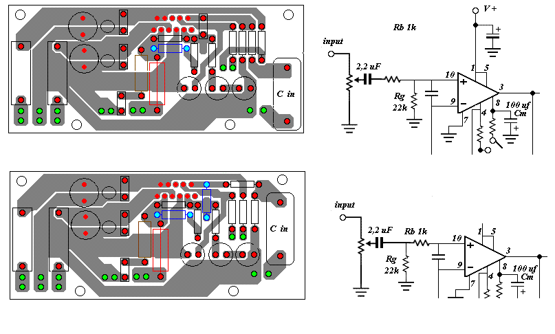

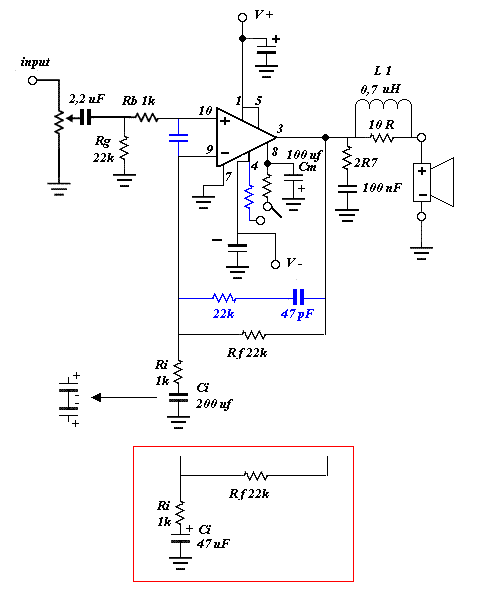

This is the schematic
The blue parts are usually optional parts
And this are the PCB´s
The same PCB can be used with all the componentes or only the most usual and is calculated for the size of some different components but of course the same value
There are only a variation in placing Rg
With this I understand the grounds returns, it´s greatly based in Elektor´s schematic

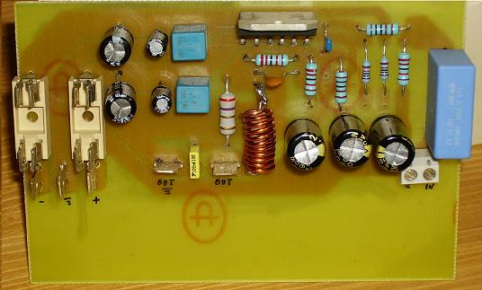

The voltage rails are very dimensionated, at all LM3886 can accept 11A and this is not a joke
Same that my LM1875 design there is very clean, no noise, no pops, nothing (well it sound, but good)
My power supply is a 24-0-24V, 160 vA and 3,3 Amperes and two 22000uF caps for each channel
