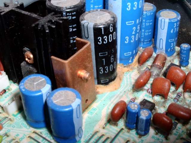

Bricolo, old buddy, that appears to be some kind of adhesive. It's meant to keep the larger electrolytic caps from breaking the solder joints and circuit traces if the player is dropped.
That type of capacitor has the pressure relief on the end that is visible. See where the aluminum can is grooved? That's what will bulge and eventually burst if the cap goes short circuit.
That stuff does look uncomfortably like electrolyte goo, but it's not.

It seems that some one has been over jealous in damping counpound!😉

that's a disgusting mess, but you know what they say...never open the burrito, just eat it. 😉

Keld said:Hi
This is the way it looks just before it blows,
or maybe this one is in a transistion period to become a tube.
Keld
No always IMO.
Some elco's in power supplies have the top rounded. Particularly the capacitors just after the mains rectifier in TV sets or computer PSU's.
It's a plastic cap, and when you push the plastic you will feel that there is nothing but air underneath.
But in some case it could be an example of what is a swollen capacitor.
Watch out when they become transparent...
/Hugo - Loves the warm glow of transparent capacitors 😉

Hi
Actually you are quite right. I just cut the cap open and under the plastic there was a nice flat surface

grataku said:that's a disgusting mess, but you know what they say...never open the burrito, just eat it. 😉
How does it sound?
like 20 years old electrolytics
bad, bad, bad
