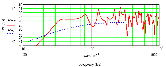

For once, I'd actually be inclined to make life easy and simply stick the Jordans in Terry's original cabinet: they'll work fine in it -dimensions aren't actually too far off the ~optimal, depending on which specs. you believe to be accurate. Ignore the ripple on the sim -in practice, 90% of it doesn't exist when the boxes are correctly loaded. You might have to damp them down a bit though -gain is something they aren't exactly lacking, as you can see.
Wish I could afford to try it myself to be honest: the Jordan's right in the kill zone for this load, so you get a box that is of reasonable size.

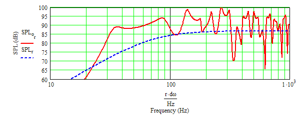

I was looking at something similar, an 51" MLTL, the length dictated by the nicely finished cupboard doors I salvaged from an office reno at work. 🙂 The results of playing around with Martin's sheets and Zaph's T&S parameters for a bit last night below, 0.1 lbs damping and 0.5 ohm source drive:
Note -WRT the dimensions Terry provided, he was using 1in material, not 3/4in. His resultant cabinet was internally, 70in x 5in x 12in (HxWxD). Driver was 30in down from the internal top.
As GM said, I'm not sure I'd call either 'best' per se -it's simply that they happen to go in & perform fairly well. It's a big box, so it's forgiving, if driver parameters are closeish to those of the defunct 1354.
