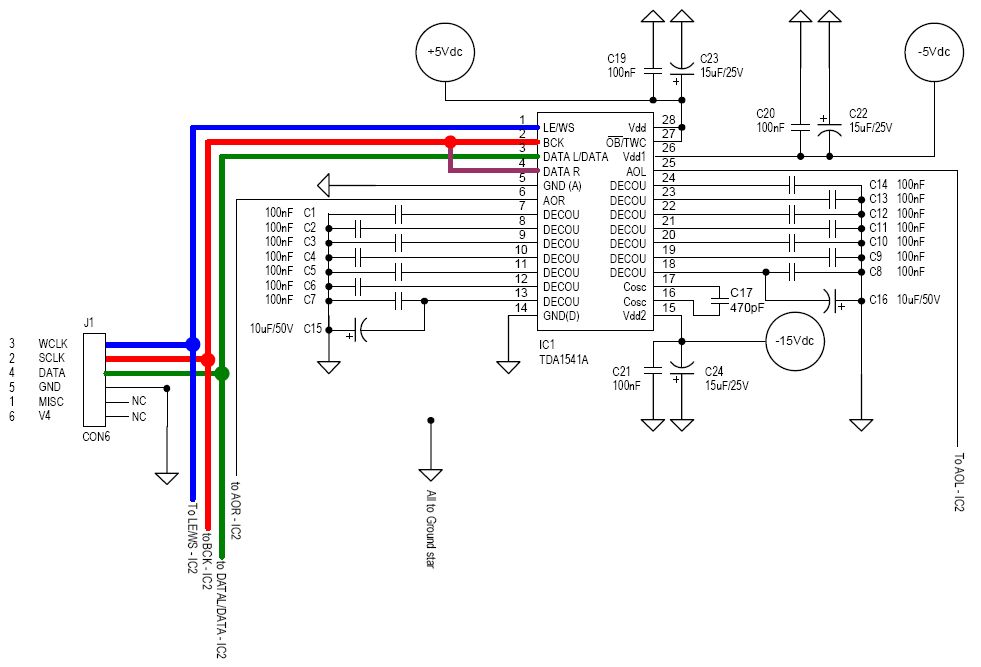

Check your pin arrangement on the tda1541a chip
My schematic says:
1 - LE/WS
2 - Bck
3 - Data L
4 - Data R
Pin 4 (data R) terminates into trace leading to pin 2 (Bck)
FWIW, my dac has 3, 10 ohm resistors in series with pin 1, 2 and 3 and pin 4 terminates into the trace going into pin 2 on the "dac side" of the 10R. Not sure of significance though.
For a pic of this see
http://home.socal.rr.com/audio_gestalt/default.htm
"TDA1541A Dac PCB" tab (I have twin dac chips and the bottom one in the pic shows the correct pin arrangement)
Typo error
Thanks riotubes,
Yes, it's my mistake, just typo error. The right connection I have done is:
Pin1: MISC ==> Not Connected
Pin2: SCLK ==> Pin2: BCK
Pin3: WCLK ==> Pin1: LE/WS
Pin4: DATA ==> Pin3: DATA L/DATA
Pin5: GND ==> Ground star of DAC PCB
Pin6: V4 ==> Not Connected
I attach the pictures of the connection.

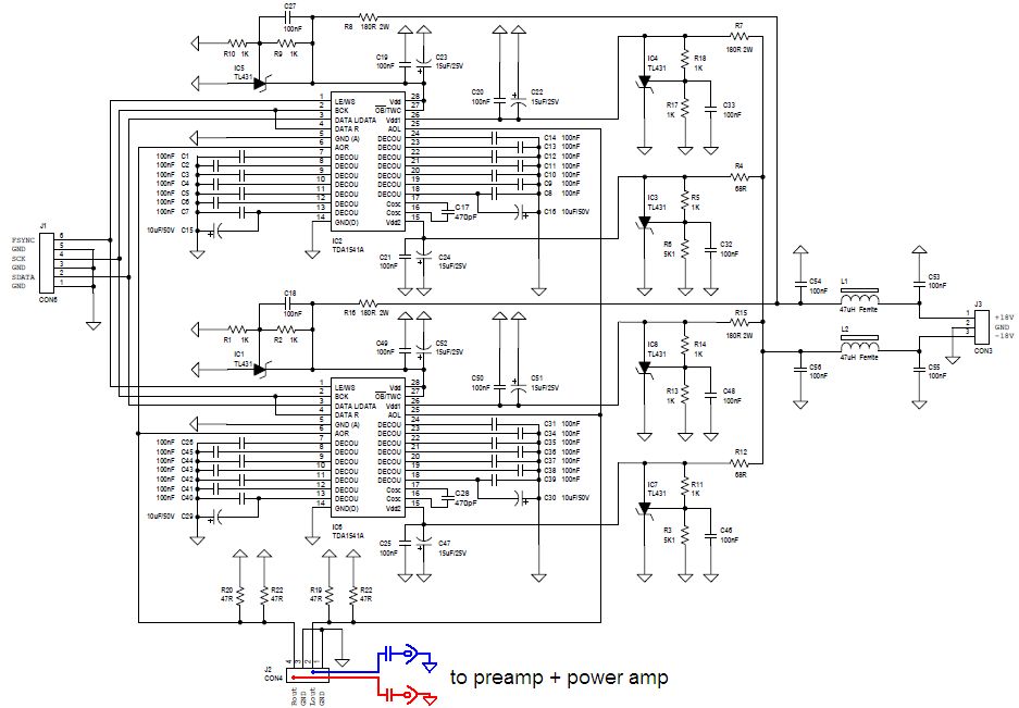

I've made a simple civ to the schematic of Torben DAC as attached file.
Although the gain is not perfect but it's working for my preamp and power amp.
Since I have only little experience to use tube design then I plan to use D1 IV stage for that DAC instead of tube. Maybe sometime I can use the tubes.
