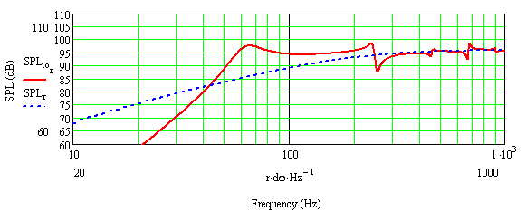

OK, well, that puts box tuning to ~65Hz -it's working more like a small MLTL. See attached. Moderately well balanced, apart from the peak at cut-off, which isn't ideal, but extension isn't great.

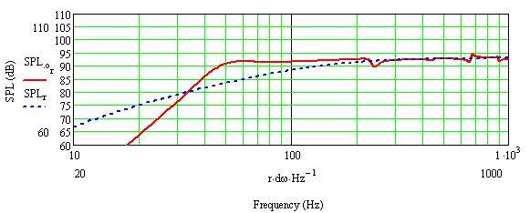

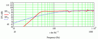

To improve LF extension, you could increase the vent length to 3.5in (there are plenty of pipes / ports available you should be able to utilise). You'll loose a bit of LF gain, but gain about 17Hz of extension, with a box tuning of about 48Hz, which is pretty reasonable for this driver in a relatively small / short cabinet.
I suspect baffle-step loss is probably causing you some problems too, especially in conjunction with the driver's naturally rising response. I suggest you put a 3ohm resistor in parallel with a 1mH inductor in the + lead to the driver. That should help flatten things out nicely. In conjunction with the increased vent length, it should give an anechoic LF response similar to the attached. To adjust the level of correction, increase or decrease the value of the resistor. Unfortunately, no voice-coil inductance figure is published for the driver, so setting a zobel value is tricky. FWIW, I'd probably try a 3uf cap in series with a 9ohm resistor across the + & - terminals. That should help a bit too. Overall, you should find the sound better balanced, with improved extension.
Hope that helps
Scott

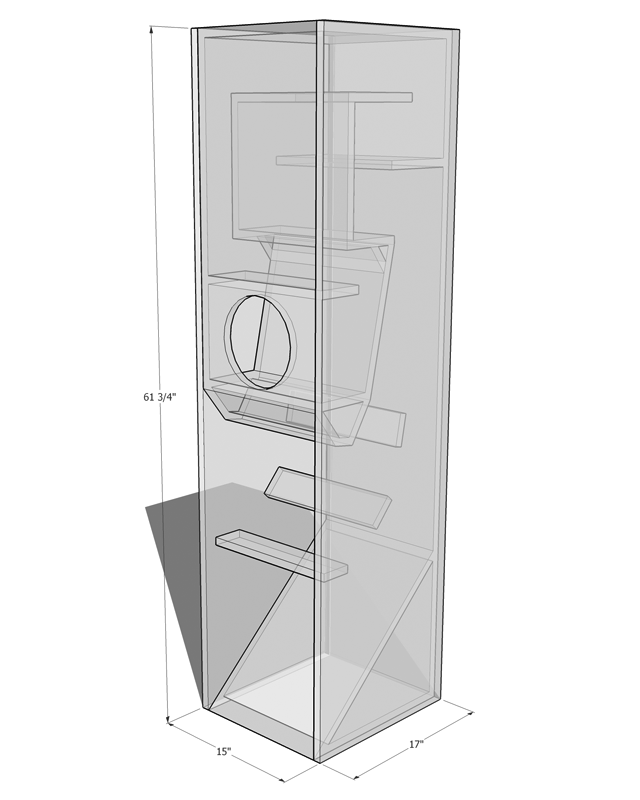

Matt, the plans for the Model III are up. Have a look. They may be exactly what you are looking for. AFAIK they are the smallest enclosures I have seen (for the level of performance). (Of course that was my intent when I designed them, I didn't want huge enclosures as I have been dealing with since I bought the ANS8s. The model 1 was a monster and took up a good deal of floorspace. I decided to go up. 62 inches high is not unreasonable though). Good luck!
Here is the link if you are interested, and a small rendering at the bottom of this post: http://www.box.net/shared/u4rs0mntw0
Tom
