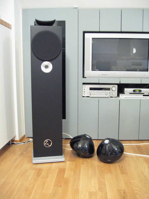

I made a pair of cheap speakers using IKEA vase (12.95 €) and Tangband W3-871S drivers (~20 €). Internal volume is about 6,5 litres and the neck/mouth gives Fb=75 Hz. I intend to add some bitumen inside to reduse ringing of the enclosure but the enclosure sounds quite dead allready with some polyfill in it.
IKEA steel bowls look great also and there are many sizes.
