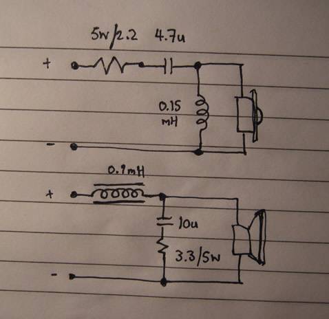

As I've moved back in with my parents, my listening room is now my tiny bedroom, so I've lent my main speakers away and am using the Tangents. They're a very cheap and poor speaker I bought about 10 years ago - my first hi-fi speakers.

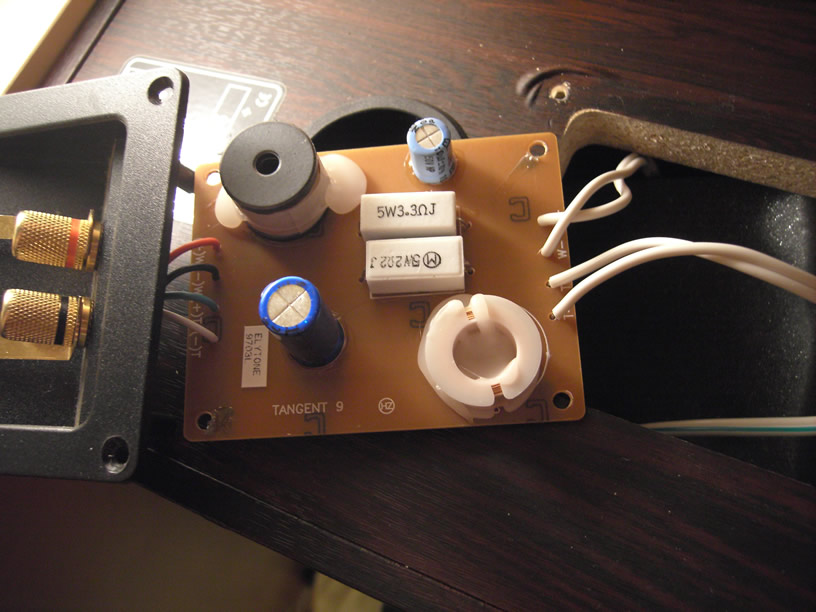

They use a 13cm coated paper midwoofer and 1" soft dome tweeter. The x-over is a simple 2nd order parallel type using very low quality parts. This was a £70 speaker after all.
To make them more bearable I decided to treat them to some small modifications.

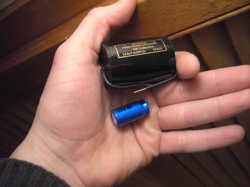

I ordered a new series cap and resistor from hificollective.co.uk and these arrived today. I went for 5w Kiwame carbon resistors as I have personal experience with these and love them, and ClarityCaps as they have a good reputation.
Here's a comparison of the 4.7u bipolar "Elytone" 'lytic and 4.7u ClarityCap from the "SA" range.

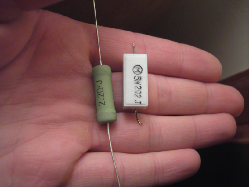

On the left is the Kiwame 5w, and on the right a typical wirewound resistor. The Kiwames are said to be extremely low noise (unusual for carbon types) and have very tight resistance tolerances, almost always leagues better than the 5% specification implied. They also look cool in pea-green 😎

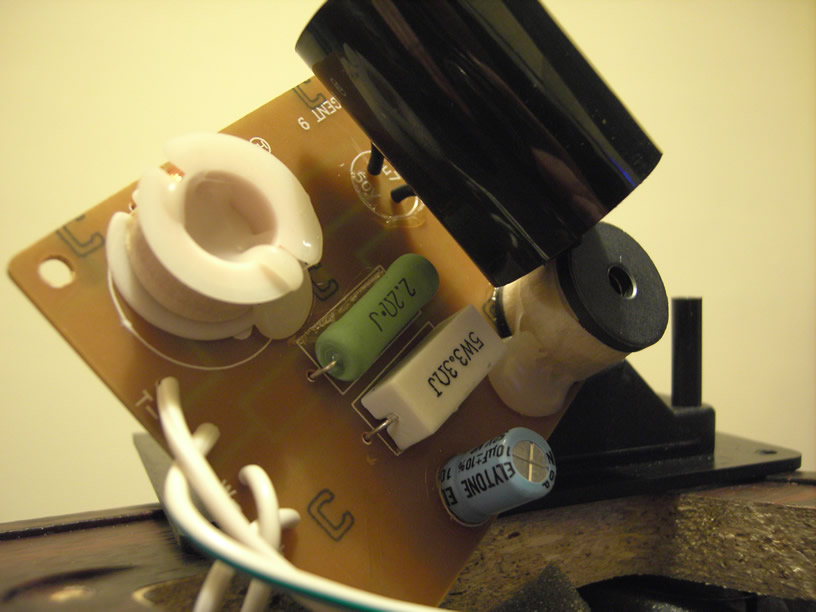

Here's what the x-overs look like now.
The sound has opened up tremendouosly, and incredibly the benefits have seeped as far south as the bass, presumably due to the way the brain processes the sounds as a whole. Of course bass instruments have higher end output too, in their harmonics. The treble is much clearer and has lost that fuzzy muffled quality I associate with electrolytic signal caps. Instruments such as xylophone and harmonica have much more energy to them.
Next I will upgrade the mid/bass driver series coils, or even try new mid/bass drivers, just for the fun of it. It must be low-cost though.
