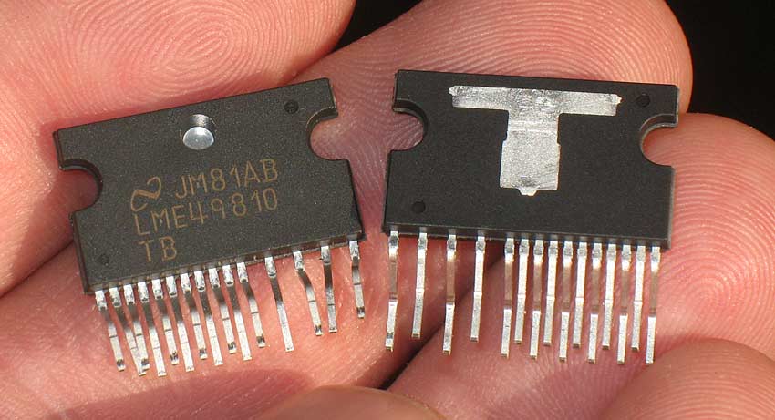

I'm planning on making a LME49830 based amp because this IC seems to be what many of us have been waiting for. I thought it would be equally big as a LM4780, it's small! Check the mechanical drawing. :nod:

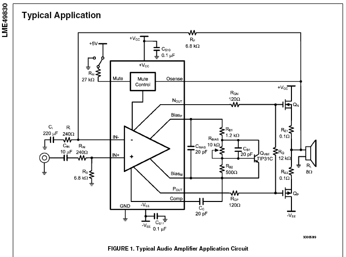

The pin "OSENSE" of LME49830 is for a kind of current limiting for output devices?
Hi Dxvideo.
From the datasheet we can read following.
I attach Figure 1 = typical amplifier application.
OUTPUT SENSING
The Output Sense pin Osense must be connected to the system output as shown in Figure 1.
This connection completes the return path to feedback the output voltage to the mute gain circuitry inside LME49830.
If the Osense pin is not connected to the output or it is floated,
high voltage generated from the output stage may cause damage to the speaker or load.
