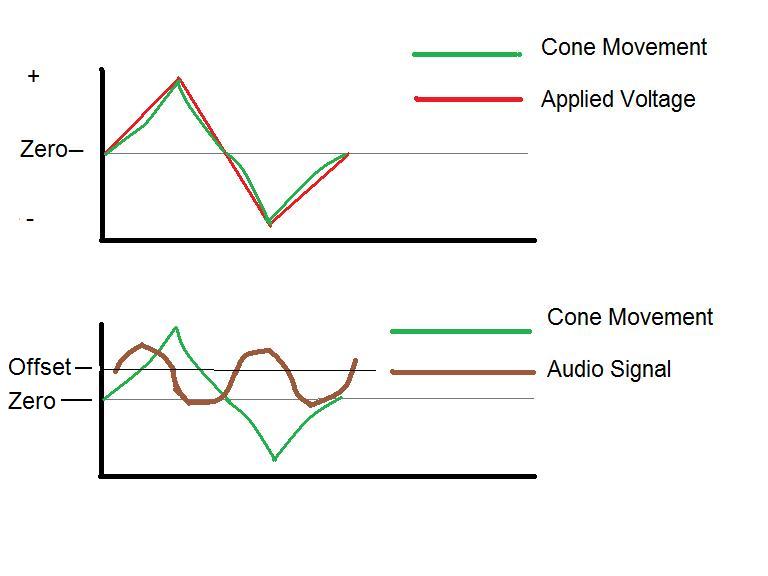

Hi, this has puzzled me for some time, wonder if anyone has any thoughts. I am thinking particularly at very low amplitudes around the zero crossing point of the audio waveform. I hope the drawing makes what I am trying to say a bit clearer. Any D.C. offset will not effect the linearity of the electronics but if the speaker cone is moved from its "rest" position by the offset, is the cone movement still linear when a small A.C. signal is then superimposed on to it. The movement of the cone caused by the offset may be small, and due to the crossover network will effect only the bass and midrange drive units, the tweeter being A.C. coupled. Anyone any thoughts ?

If the driver is linear over the range of excursion needed by both the offset and signal, there shouldn't be any problem. If the offset pushes the cone into some non-linear region, that's bad, but hopefully that's nowhere near small signal conditions. I believe all drivers compress with increasing amplitude, so you're thinking the right direction, it just comes down to how much offset, how much signal, and what driver. I don't like much of any offset, just because there's no reason to have it in a good design.

the effect you are describing is real and I think the answer to your question is yes, a DC offset causes distortion. How much and how audible is another matter. But the principal is correct, the DC offset causes the cone to be displaced from its normal rest location. AC signals do not remove the offset, it persists in the presence of the audio signal. I think the best response is to find an amp with very small offset, mV, if possible or adjust for low offset.

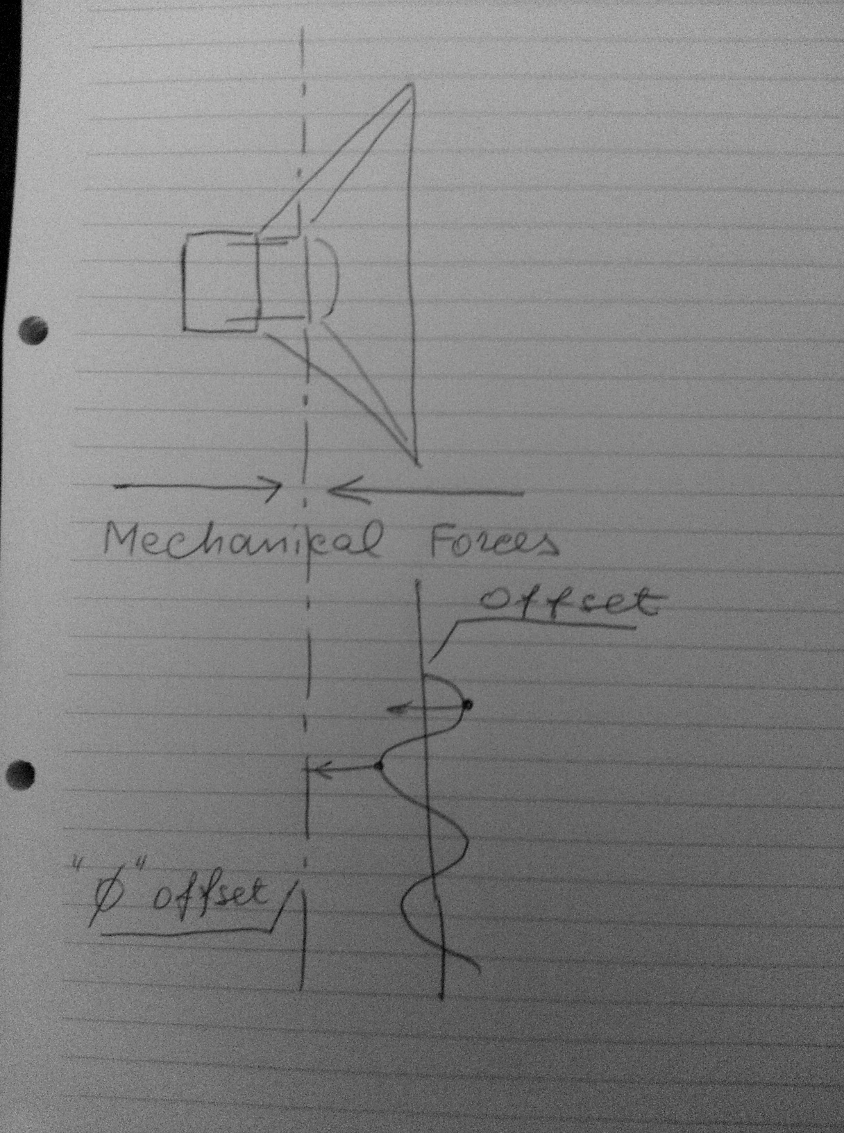

In my opinion, the speaker diaphragm is at mechanical rest and move from this point forward and backward. If for some reason there was another mechanical quantity causing an off set in one direction but happens to be related to a standing fixed voltage, the diaphragm will start movement from this new rest point as if it was the old rest point the same way as it did without the additional bias and nothing will be different. When one reaches to extremety of excurcion then the one direction may be at its mechanical end due to the bias while the other is still far from it and you will find rapid distortion increase due to cone breakup. The distortion is asymmetrical and higher order artifacts will rapidly be encountered.
My 2 cents
This is what I think about it.
As soon as magnetic field starts moving the cone to either direction from the neutral position, it works against the mechanical "spring" type of force. This force may be considered linear in certain range of cone positions.
However, even considering it linear, as soon as you look at the picture with certain DC offset, you will see that half-wave magnetic field still works against the mechanical resistance, the other half-wave it is supplemented by its force, pushing in the same direction.
At low offsets it is negligible, but the effect is the stronger, the higher DC offset is, resulting in distortion increasing accordingly.
By the way, the lower amp output impedance is, the lower the effect is, as the low impedance output will control the cone tighter, reducing the influence of asymmetric mechanical resistance.
