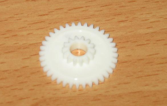

One of the gears that help to move the sledge in my CD T1 is broken with the result that the sledge doesn't move at all. However I can move the sledge by hand and everything works fine.
I saw today that there is a company http://www.chsinteractive.co.uk/ that stock spare parts and they seem to have a few of the gears for this player but which one is it that I want? The one broken in my player is white and consist of 2 gears one small with I think 13 teeth and the larger one with about 40.

I have a COPLAN CDA 288 with a TEAC CMK4 VRDS with the same problem.
Is it this the gear?
I'l try to find one but is almost imposible.
Anybody can help us?
Yes, this is the same gear as in my player. One idea I have is to buy generic gears from a supplier of mechanic parts and build a new gear but I don't yet know if I can find the correct pitch and number of teeth.
The company I linked to http://www.chsinteractive.co.uk/ have several of thge gears for this CD drive but I don't know which one is which, does anyone have the repair manual so we can identify the gear name/part number?

Probably not a bad idea to replace all of the gears in the sled drive train - this is what I did in my Sony.. The gears should not be all that expensive.

I have done this now to many obsolete impossible to find gears for CD players.
Get some battery clock mechs couple of dollars each from electronic, hobby or bargain shops, three or four different makes, pull them apart and get all the gears out, match up your gears.
Drill out the holes to match the Teac spindle size then use the drill as a centering axle with some grease on it and then glue the two gears together using "Davcon B", a two part 24hr drying time hard as nails epoxy glue.
And there you have it, your own home made gear.

Yes, I did! the gear I ordered from Charles Hyde in UK was indeed the right one and when I had fiddled a bit with the initial position of the big gear that move the CD tray the player now works perfectly with very smooth operation and will probably give me many more years of service.
The total cost for the gear including P&P was 15GBP but I think it is still a low price to pay instead of scrapping what is otherwise a very well functioning player.
