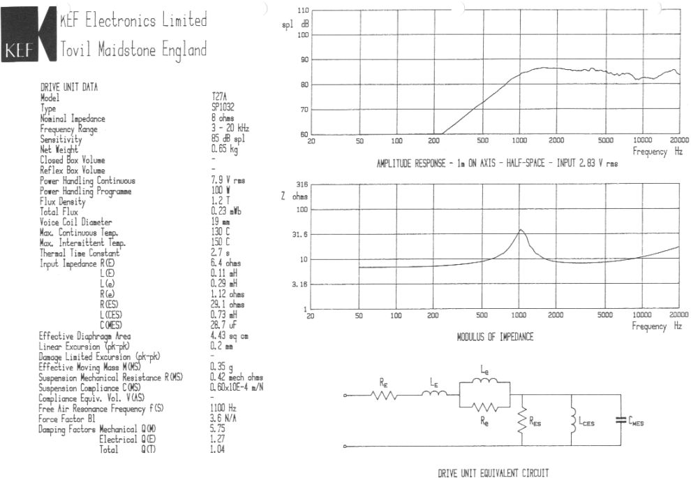

I have some T27 FR, but they are with the XO in line (part of a paper on the XO in teh 104aB) -- i can dig that out if you think it useful. Attached is an impedance curve from a set i sold on eBay.
dave

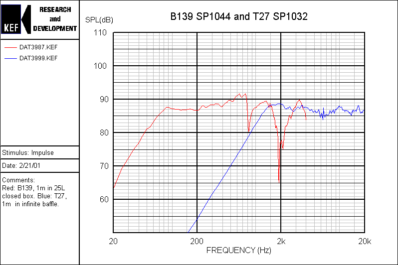

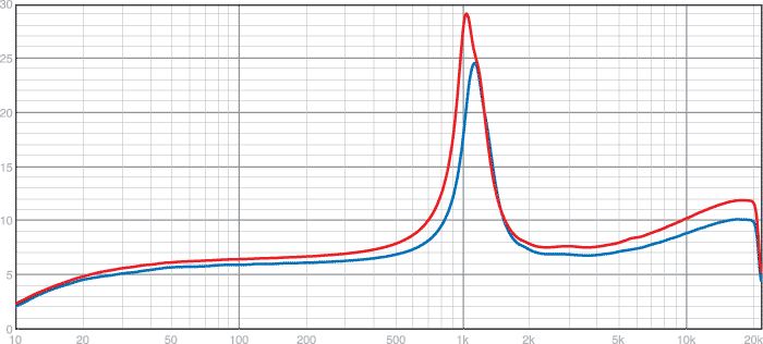

Thanks Rolf and Geoff !!! I might have enough now to create .frd and .zma files.
