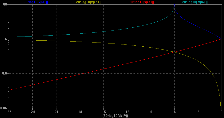

Originally posted by KSTR
Hi Lynn,
Um, I'm a bit bewildered from your comments to be honest. I for one had no difficulty to find the required matrix formulae in the patent, albeit they are not written in classic matrix form. It's all right on the front page:
Lout = Lin - m*Rin
Rout = Rin - m*Lin
Cout = (1-m)*(Lin+Rin)
In the more general form one replaces (1-m) with another factor n and then we have all degrees of freedom in useful 2-to-3 linear revectorizing (as it is put sometimes). With these two factor I played a lot, and found, confirming the results of Mr.Miles and Mr.Bongiorno, that both factors at ~0.5 gives the best results (and, btw before I learned about the Miles patent). I also have two working circuits and some ideas for "high-end" circuit variations.

Now my point is that these decondings will surely work very well with material produced for it. Normal stereo recordings are more likely produced to work within the 2-channel reproduction domain, speakers at +-30deg angles. So the soundstage/imaging illusion will be distorted, out of proportions, and not be what the producer had originally in mind. This is because recording techniques have been empirically optimized to work within that 2Ch, +-30deg paradigm. There is excellent work from Eberhard Sengpiel on these matters (a renowned -- grammy awarded -- classical sound engineer and unversity professor). Unfortunately it's available in german only. Localization cues come from interchannel level (dL) and time (dT) differences. Equal signs of dT and dL denominate like differences, with ie the louder sound also being earlier. According to the work of Sengpiel we can express approximized statistical localization b (ranging from 0% to 100% of left or right, 0% meaning centered) of wideband sources as follows, with like dL/dT:
b(dL, dT) = b1(dL) + b2(dT)
b1(dL) = 1.72935e-4*dL^4 - 4.932668e-3*dL^3 - 0.148525*dL^2 + 8.818633*dL
b2(dT) = 21.090084*dT^4 - 61.293151*dT^3 + 17.099029*dT^2 + 107.74868*dT
(dL in dB and dT in ms units).
Therefore, the goal of a rematrixing that wants to be compatible to normal stereo in imaging must try to preserve these relationsships between recorded dT/dL and corresponding localization as much as possible. This is what a matrix factor of ~0.5, together with 45deg spacings between equidistant speakers, does quite well. I tested that with pink noise bursts with various dL/dT relationships including the trading region (different signs of dL and dT). It is not identical, though, but quite compatible. Eventuelly, decated recordings for rematrixed playback deems necessary, with new empirical research on how dL/dT results in localization with that specific scheme.
First, I think we should not mix true 3-channel recordings/playback with the 2-->3 rematrixing issue here. I noted the necessity of the mentioned adjustment indeed, together with some interesting effects of phantom image size/precision: The more dT dominates interchannel differences there more diffuse phantom images become, compared to conventional stereo. Also with true-AB (zero dL, L and R components identical but delayed in time) some degradation in timbre takes places, because of the apparent (and distinct) comb filter effects of the summing in all three channels which do not perfectly compensate each other acoustically. OTOH, with mainly dL and no or little dT content (as with any true XY-recording and close-miked/panpot stereo) images generally sharpen, seemingly because real and phantom sources change roles: Mono centered signals are (dominantly) a real source from the center while L-only or R-only signals now get phantomend with center contribution plus antiphase side contribution. This leads to my impression that the spatial stereo illusion with most recordings gets more convincing, soloists being smack center while ambient info (which is basicly uncorrelated L/R-only signals) gets more of a true ambient character because it is more diffuse. This more convincing seperation between direct and reverberant sound, together with the better correlation of true vs phantom sources to the typical weighting of soloist vs comping in most music and recording styles makes one of the main improvements of that specific rematrixing. The other being the more invariant and stable sweetspot w.r.t. sideway head movement and especially head turn (where the normal stereo quickly deteriorates). The sweetspot is way shorter, though, as soon as you leave the equidistant zone (L/R vs C) the top registers start to fall apart in the imaging.I hope people explore these 3-speaker systems - no reason why not, since many of the earliest stereo recordings were originally made in 3-channel format, and would benefit from 3-channel playback. I'm pretty sure the Center level needs to be adjusted for recording technique, though - just a whisper for true-Blumlein recordings, a little more for ORTF-style crossed-cardioids, and "normal" level for pan-potted and multimiked recordings.
This assessment process is exactly how I did my correction to account for the different speakers I had to use. I would lessen the statement "no changes in timbre" to "natural changes in timbre", corresponding to the timbre changes of a real mono source, moving between speakers (have you SO carry a speaker around while your listening ;-). Of course I could not do that to perfection, and therefore I can back the rigorous requirement of truly identical speakers in every regard (including precise equidistant setup, with a point some inches in front of one's nose as the center point) plus well balanced room acoustics. Both is also required for normal stereo, so this is not a specific point of rematrixed stereo.A good way to assess the overall quality of the system is pan a pink-noise source across the soundstage. There should be no changes in timbre as the pink-noise is slowly panned - in most systems, though, you'll hear odd colorations as the sound moves. The goal of a 2 -> 3 static matrix is to minimize the coloration as the pink-noise is panned - this requires phase-matched loudspeakers with identical polar patterns and the Center channel at just the correct level.
- Klaus

Attached is a damping (in dB) plot for a panpotted signal with the trinaural / optimum linear matrix, m=0.5, panned from center to the left. Blue (inphase section) and turqoise (anti-phase section) is left output, red is center and brown is right output. BTW, the damping at the -6dB pan paoint from the channels is 2.5dB (gain=0.75 each). I think it demonstrates the reasonable (but not perfect) output channel separation.

Hi guys!
Jean Hiraga in his book "les haut-parleurs" describes an upgrade of the Jensen S-100 speaker that might be of interest in your case.
The matrix looks as follow:
Lout = Lin - Rin
Cout = Lin + Rin
Rout = Rin - Lin
The three speakers should be placed as close as possible with an angle of 135ºC between each. The center speaker is facing the listener and the side speakers are 90º to each other.
The output level of the center speaker is adjusted in order to widen the sound stage accordingly to the taste of the listener.
Only a 2 channels amplifier is required since a resistor network is used to add and subtract the left and right signals.
/Etienne
Lout = Lin - Rin
Cout = Lin + Rin
Rout = Rin - Lin
/Etienne

+0.966 Left In, -0.259 Right In = Left Out
+0.707 Left In, +0.707 Right In = Center Out
-0.259 Left In, +0.966 Right In = Right Out
Where does these coefficients come from ? Any references ?
- Elias
- Linear 2-->3 Rematrixing for Speaker Signals
