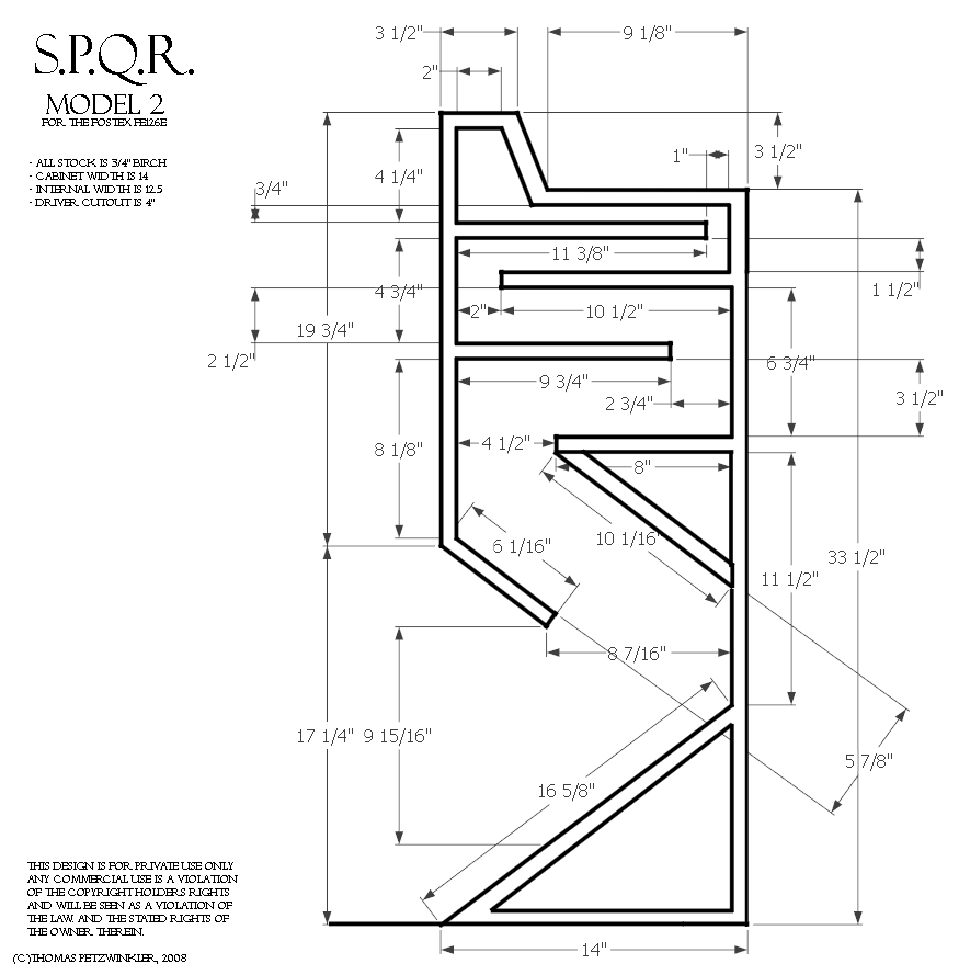

S.P.Q.R. Model 2

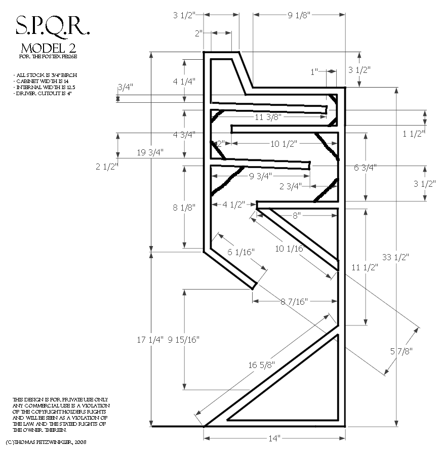

I would like to offer a new design fpr those interested in building: the S.P.Q.R. Model 2 for the Fostex FE126E. It sims extremely well and looks as though it will be a fantastic build. I, myself will be building within a couple of weeks. If anyone else would like to take the plunge and build let me know. I would be interested in following their progress. This plan and the design contained herein is for private use only. Any commercial use is a violation of copyright law. Thanks everyone!
Tom

gurley123 said:
Hmmm...Nice wide baffle. You may not need a BSC. Plus it has that nice Hiro/Sachiko stepped path that should make it a fairly easy build. Kudos Harderror.
I really need to make out a list and prioritize my project schedual. Too many nice things to build 🙂 .
Thanks! When designing this enclosure, one of my priorities was a wider baffle. That and a square footprint of modest but not minuscule dimensions. These two design requirements made for a bit of a shoe horn situation. Thanks to Scott, Ron, and GM some of the kinks of this sort of design were worked out.
I can't wait to build it either!
Next design will be a slightly more modest enclosure for the ANS8 than the one I built to begin with. I am hoping for a footprint of 15x15 and a height of no more than 4 feet with a tuning at the fs 37Hz of the driver. Now that will be challenge!

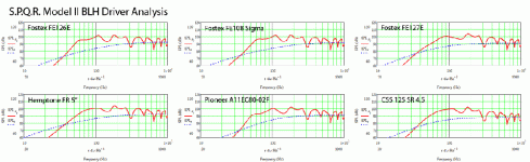

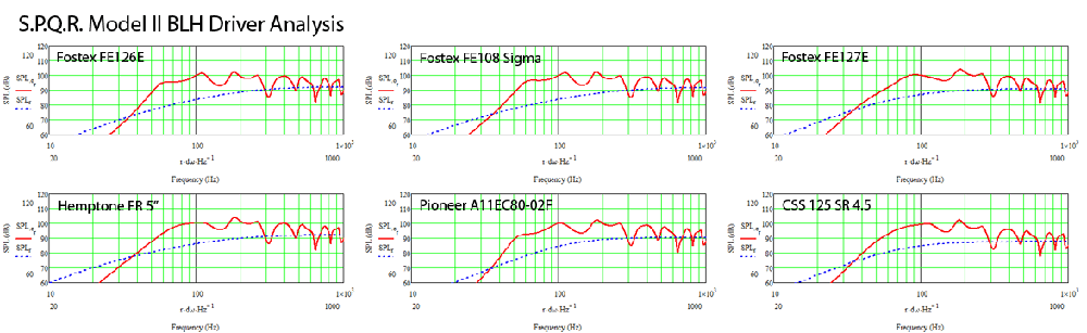

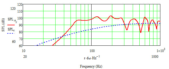

Alright, I sat down and did some plots tonight. I am really very surprised by the results. I knew any horn ready driver of around 4.5 inches would work great. What I wasn't ready for was that a few that don't look like they should work, will. They may be a bit bass heavy but that can be dealt with. The Hemptone and the CSS will all work reasonably well. With a bit of work the bass can be tamed and you should a have a fine sounding system. The Pioneer looks like it will work without any work at all! Not bad for an 11 dollar driver. Having had experience with this driver, after a good deal of tweaking, it can be passable and even enjoyable. So, there you go. The Model II will work with any number of drivers.
All that being said. The Fostex FE127E looks like it is a no go. I tested one other that was a no go but I did not include it. The Hemp Acoustics FR4.5c. It, like the fe127e just won't comply with the design which is understandable.
Good luck everyone. I hope some more of you will be interested in this enclosure now that you have some choices of driver. Obviously it was designed with the FE126E and the FE108 Sigma in mind but others will work, so...
Tom

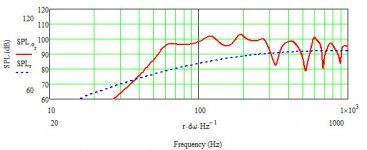

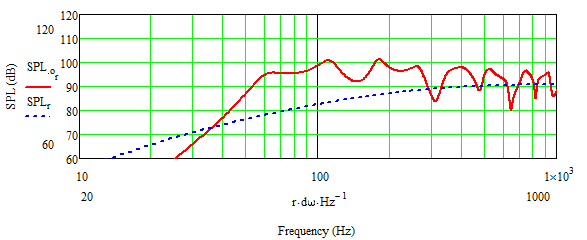

So, after reading the best 4" driver thread I thought: "I am going to test the Tang Band 4" Bamboo!" I have always been interested in the driver but have not purchased a set as of yet. I think I will now. I am super impressed with its response in the Model II. Here you go!
Tom
The published spec for the FR4,5c do not jive with actual measures. Pusblished is close to FE127 spec, measured is about half-way between FE126 and FE127.
dave
So the Hemp acoustics may work a bit better in the enclosure? That is reassuring. I would love to hear from someone that is interested in using this driver in this enclosure. Thanks Dave!
BTW, does anyone have the actual measured specs on this driver? That would be great if they could send them to me. Thanks again!
Tom

Tom,
After the lashing I got for daring to suggest the A11 in the FH, I have to admit that I still do not completely understand ( nor am I sure I care, to be truthful ) why the cheap'lil booger won't work. I am willing to, as the say " take their word".
Now, onward and upward....
Some questions/comments reguarding your new cab designs
"Whut duz ES. PEE.KuhUU. ARR. stand for?
Seriously, the connection (Compression?) chamber directly behind the driver on the plan shows a vertical dimension of only 4.25". Some of the drivers shown on your Sim. plots are 4.5" drivers. Nearly every plan I look at shows chamfering the back side of the driver cutout to allow the driver to " breathe ". Is this an oversight or some deep dark speaker design alchemy?
As I am still looking for an inexpensive plan/driver combo ( though I haven't given up on the FH's, I am now also considering the Metronomes, and even some of the Changs. I do not wish to step on toes, just get equipment which will please me, for little $ as possible. ).
I have Two + sheets of the plywood .5" ( less 1/64th ). If I were to build S.P.Q.R. II's How drastic would the effect of the thinner ply be on this. I could double panels as necessary to reinforce .... My personal preference in constructing would be to make a reversible template for my router first, and dado the inside of both side panels, then glue/clamp assembly in one go. I would rather have more surface area in the joints than just simple butt joints.
These cabinets also address another of my concerns, that being sensitivity to placement. What do you estimate the best placement would be? what is your estimation of how these will image?
Another bit on the plan, what is the radius of the opening cutout for the horn exit, at the bottom of the side panels. What is the 17 & 7/16" measurement at the very top of the plan?
Tom
Umm, not to bum you out, but a copyright does not protect the underlying design you have published here. It does however protect the digital image (which is an "expression" of that idea).
