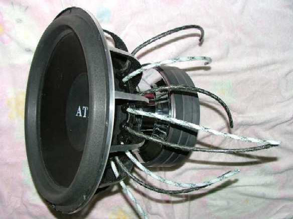

Hi svante
Thia picture that i have ever seen. What do you think about this?
They want the spl or not?
regards
Thawach

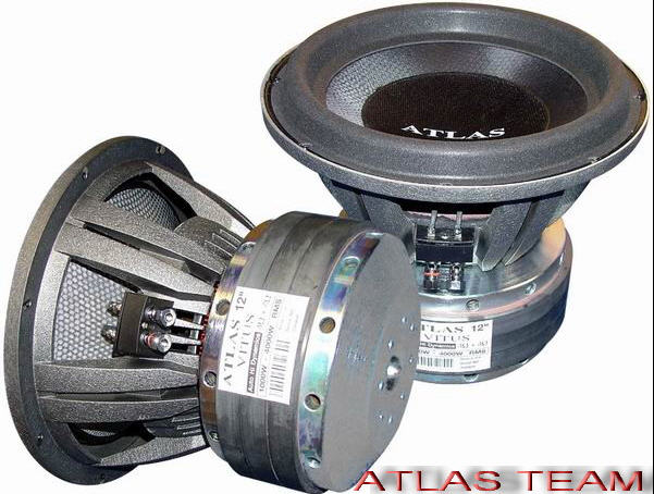

Hi
thanks forr, And here i copy this picture to post.
it is the best seller in thailand(car audio) i cannot know the
manufacture. On thai web have a little detail.
8 voice, 1 voice=1 ohms I have not seen before.
I think the manufacture want a high spl. I don't know about the
deep bass.
