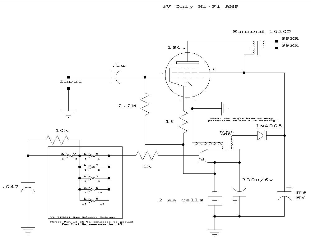

Possible to up the power?
Wiring a wall transformer to this amp would be dirt simple... but... how much voltage? Would more input voltage make the amp more useful? (read😛owerful)

poynton said:
Please post the circuit.
This might be it. Don't remember where I found this schematic but it fits the bill.
