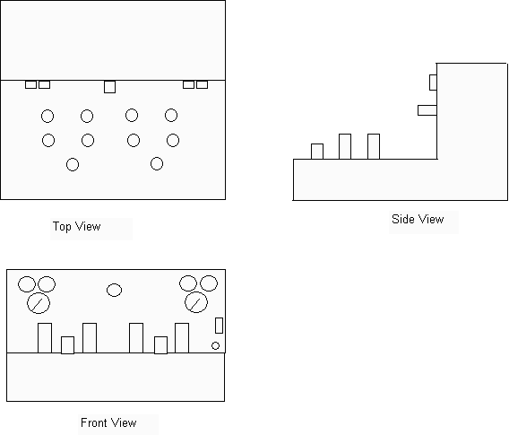

The chasis I am using is being custom made by a friend of a friend who owns a metal fab shop. It's all aluminimum and is 13X13 inches at the base. The base is 3 inches in height. The back 5 inches of the base will stick up an additional 6 inches. So the first 8 inches (front to back) is your standard 3 inch box. But the back 5 inches steps up to form a backboard on and in which I can put things. In the flat base the main board of the amp goes with tubes thru holes - standard style On the back, step up part I am installing the tone and base contol board, placing the transformers, installing some retro VU meters, and installing all switches, illumination indicators and pot knobs. I am relocating all volume, tone and bass pots of course and adding a 4 way stereo rotary switch to change between inputs. On the tone /bass control there is a tube. That sticks out with the top pointing to you, 90 degress from the other tubes sticking up.
I'm going for a retro, industrial sort of look. Attached is a sketch.

Regarding the comment about heat etc. The heat will go up away from the back - I also did a cardboard mockup to make sure the hand burning thing would be ok. You make some good points and may be ultimately proven right but I'm forging ahead. One thing I can do if needed is put in a fan. Still 90% of the heat in this amp is right off the top of the tubes. As they are out in the air the heat should not build up in that back area. And I do plan to have the back covered with a grill.
