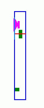

Suppose we want to build a tall, narrow enclosure that is 46" high by 8.5" wide by 4.5" deep inside dimensions. It will have a base so it doesn't fall over.
The illustration shows a Ported enclosure, but it could be a Closed Box.
Such a box will have a huge standing wave, very narrow band, (like a "crack"), at 280 Hz, which is the wavelength of 46".
In order to prevent this, we decide to build a divider that prevents the standing wave from hitting the speaker at 280 Hz. This divides the speaker volume into two chambers-The Small Chamber with the woofer, and The Large Chamber with the port, (if it's a Ported system).
The idea is keep the speaker in a smaller enclosure until the frequency goes below 280 Hz, then have The Large chamber open up for full volume around the bottom octave or so. This means that The Small Chamber would not have any standing waves that were not very short wavelength, therefore very easily absorbed by the inch or so of stuffing on the walls of The Small Chamber.
Let's say the tuning frequency will be 50 Hz.
A) Will this idea work without response irregularities?
B) If the idea does work, what would be a good frequency to tune the interior divider?
The illustration as shown shows The Small Chamber as being one fourth of the total box volume. The ratio is not set in stone. You can make the The Small Chamber one third the total box volume if you want. Just want a divider to prevent standing waves of low frequency from forming.
My guess is to make the vent of a size to tune The Large Chamber to 200 Hz, which is half an octave beneath the standing wave of 280 Hz. That should free up the total box volume when you need it.
With more and more tall, narrow enclosures being built for aesthetic and other reasons, I think this is a good way to cure the standing wave problem.
For the advanced course, we can discuss two or more dividers. However, for right now, let us deal with the guidelines to make just one work.

Mr. Feedback:
Thank you for responding. Yes, there is a kind of aperiodic enclosure where a port to another chamber opens up that chamber at certain frequencies. There is also the double chamber reflex which had a thread devoted to it some time ago.
But what I am interested in here is to establish some guidelines as to how to tune a chamber so that the bass reflex or closed box acts identical to a non-divided reflex in the bass region, only the standing waves are broken up.
I realize there are alternative enclosures, such as the double chamber aperiodic, that have merit in and of themselves, but I want to put them aside momentarily and just concentrate on making the Reflex/Closed Box work normally with a divider.
With many builders no longer satisfied with the squat enclosure, and increasing attention being paid to tall enclosures, (not necessarily Transmission Lines), I thought that would be a good thing to establish for future reference.
The dividers can perform double duty both as braces and standing wave preventers. I just want to establish how big the vent in the dividers, (which vents might be no more than a hole in the dividers-no pipes), should be not to interfere with the bass action.
We know that in Ported enclosures, the vent action only extends about an octave above the tuning frequency. After that, it is essentially equivalent to a Closed Box.

Before moving on to the low-pass filter concept I'd be interested to know how much this 280 Hz standing wave could be mitigated by having the bottom at an angle - for instance putting a wedge shaped piece of MDF 8.5" x 4.5" at the bottom. This wedge could go from 2" thick at the thickest down to nothing.
In theory, this should give an even spread of the standing wave frequencies from, say, 280 Hz to 293 Hz.
What do you think?

7V:
My initial reaction would be that such a piece would not give enough spread to mitigate the standing wave.
On the other hand, I saw a response curve in a test where Audio magazine tested a Pioneer speaker, 4 feet tall, that had this problem. The "crack"-a large dive upward followed by a large spike downward-was very narrow band. So such a small difference in the bottom might spread the phenomenon across enough frequencies to mitigate it with a decent amount of stuffing.
So, offhand, I would say that something like your approach has a chance for success.

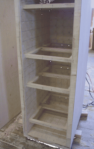

By the way, the illustration below is from a speaker project by Dan Cramer. The entire site is very instructive and worth checking out. Give the page a minute or two to load.
LOL, those random blue spots are not on the original picture!
http://www.hilberink.nl/codehans/tannoy7.htm
Even speakers less extreme, but built along similar lines, would benefit from these guidelines.
So, having (possibly) added a wedge at the bottom, my next question would be: what if we then had a ledge (at an angle of course!) with a gap in it for the port, rather than a tube? The ledge could be 1/2" or 1" thick (which would be the equivalent port length). Is there a gap size that would be right for a suitable low-pass filter?
I suppose that, given that it's inside the cabinet, a tube wouldn't cause any audible problems through air-flow but still, let's do without it if we can.
Steve
Steve
And yes Keltic
(having just seen your last post with the photo) I know where you're coming from and I think you're absolutely on track with this approach.
I'm going in a similar direction myself.
Steve

7V:
I put the divider with the port in it just to illustrate the concept. By all means, if we can make the port just a hole in the divider, let us do so. After all, there are plenty of speaker enclosures, especially PA enclosures, where the port is just a hole cut in the wall of the enclosure.
I mentioned the idea of a slanted divider earlier. While I think that is definitely the best way to go sonically, for ease of construction purposes, I would like to investigate the straight divider as well. Still, let's go with the slanted divider for now.
Okay, then we have 2 questions.
A) Where the should the divider go-that is, how big is The Large Chamber compared to The Small Chamber-or should both chambers be the same?
B) In our example-a 46" high enclosure with a standing wave of 280 Hz-how big a hole in the divider should we make to break up the standing wave while leaving the port action unchanged from an undivided enclosure?

Kelticwizard,
I have played a lot with a 1m (39") tall enclosure to eliminate the standing waves with variable results. The best solution seemed to be similar to the TL designs - placing 8-10 sheets horizontally evenly distributed starting at around 2/3rd height of the cabinet.
In my case the standing wave effect appeared at 180Hz and in your case it is 140Hz (half wave) not 280Hz. Some tapering also helps.
I have also tried the two chamber setup, but this way you actually create another Helmholtz resonator which sucks energy from the other one. This was clearly seen from the nearfield measurements.
All I can tell, it is not easy to get rid off the standing waves in this kind of cabinets, but good luck whatever way you go !
Most of what I know comes from a review of a 4 foot tall Pioneer reflex that appeared in Audio magazine perhaps a decade ago. It seemed to me that the narrow-band spike that appeared was at 280 Hz-but I cannot say for sure that it was not 140 Hz. I do vaguely remember the article mentioning half wavelengths.
If the spike is indeed at 140 Hz, that makes matters worse, since a port tuned to 50 Hz will still have action slightly above 100 Hz. Not much room for the action of a second resonator to be totally separate.
AndrewJ said:The best technique if using stuffing is to re-locate the vent away from the bottom of the enclosure towards the top, preferably on the back behind the driver, then put a layer of absorbant at half the height of the enclosure. Use for example the stiff, self supporting,fibreglass insulation about one inch thick. The standing wave will have maximum air velocity at this position, so is most effectively damped without needlessly overstuffing the cabinet.
If worse comes to worse and we cannot eliminate the standing waves by creating wooden or MDF dividers, at least we know the most effective way to use the stuffing. thanks.
The alternative of using a tuned resonator also works very very well, but is extremely difficult to tune. Pioneer regularly use the technique in speakers made for the japanese market. Their technique uses an internal half-wavelength pipe of carefully calculated diameter and stuffing.
