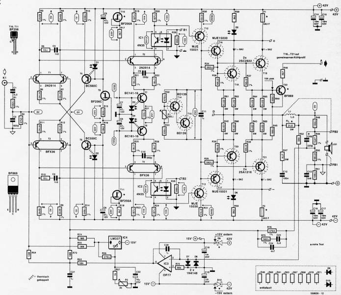

Has anybody tried what at least in the German issue was called the "Ulti Amp"? It was published in 5/95. Measured specs were more than excellent, but I'm interested if anyone can comment on the sound.
The dual transistors used in the two gain stages (2N2914, BFX36) have long been obsolete anyway. I've always wanted to build one (some parts are still in my junkbox), but never proceded as I came across other concepts (current feedback, class A) I found more interesting.

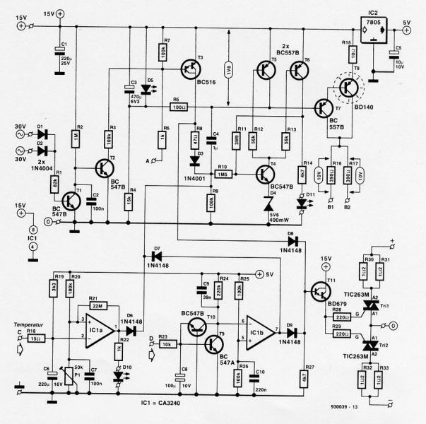

The protection circuit is somewhat special (it shorts the PSU rails via Triacs instead of opening a speaker relay) and can easily be adopted for use in any amplifier.
Sure.
Note that this design was an "update" from a high-current audio amplifier for very low impedance speakers, using the same PCB. Irritating traces of those modifications are left both in the schematic and PCB layout.
Here is the main circuit without power supply and protection circuit. The optocouplers are used as an electronic switch instead of a speaker relay.

Protection circuit. Optocouplers are connected at B1 / B2. The Triacs short the supply rails to trigger the secondary fuses.
The circuit was published in 5/94, not 5/95 as I wrote in post #1.

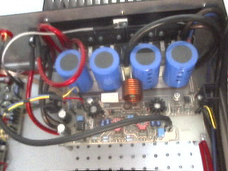

I have build four of these mono blocks. The sound is detailed, clear and the bass is extremely controlled. There are some serious problems with the building of the amplifier. I can give you details if you want to. I redesigned this amplifier, it is almost ready.

I won't build this circuit in the near future (too many other projects on my list), but a friend of mine started this project and since he has no experience in electronics, I promised to help him. We did the original PCBs at home, but building the circuit on them was a mess. You probably found the same errors as we did 😉.
Anyway, I've started a new PCB layout (single sided this time), but we were both quite busy in the last few months and didn't go on with the project.
My friend might be interested in buying the original dual transistors from you, please email me for details. (We hand-matched similar single transistors and thermally coupled them.)
Please share those issues, I've ordered today most of the parts for an amp which is based on the ultiamp. The etching of the modified schematic is due somewhere this week, so if i have overlooked something it is not too late to repair...
Thanks,
Emiel
known problems ULTI AMP
Hi Emiel,
First of all the BFX and 2N matched transistors can be replaced by the MAT02/03 or the SSM2210/2220. The matching of the MAT and SSM types is better than the BFX/2N. They can handle the Vce is this schematic.
Because of the high gain in the first stage, use 0.1% collector and emitter resistors. Otherwise use offset trimming.
BFX and 2N collector currents should closely match !
The FET current sources (BF256) give an unprictable current because of variations in IDSS. Usource should be higher than Ugate.
Current sources BC141/161 should extended with heatsinks.
They get extremely hot because of the high Vce.
The MJE15030/31 (T12/13) should also be extended with proper heatsinks they also get extemely hot.
The Zobel network R47/C12, don't use a wirewound resistor but a metalfilm. (3W type)
The function of R51/C13 is unknown to me because of the proposed connection.
Regards

SSM2220 has a max Uce of 36V
in the original circuit of the ultiamp the Vce voltage is about 39V, this wil kill the component after some months, and this is the voltage without input signal, than the voltage will even increase or decrease ( depending on the wave )
Maybe you could mesure it to be sure you don't destroy your nice creation
( SSM2210 has a max Uce of 40V )
Greetz Rudy ( building someting simular @ the moment 🙄 )
SSM types
Hi Rudy,
I did not use SSM matched pairs in this amplifier.
I used the 2N2918 and BFX36 matched pairs for the gain stages, according to the original schematic.
If you modify the schematic it is possible to use SSM or MAT types, last mentioned pairs will make the sound better !
Just lower the railvoltage or use some zenerdiodes in the collectors.

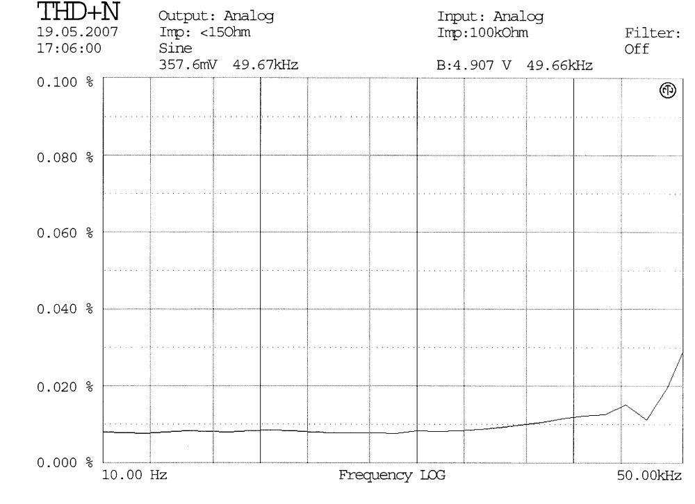

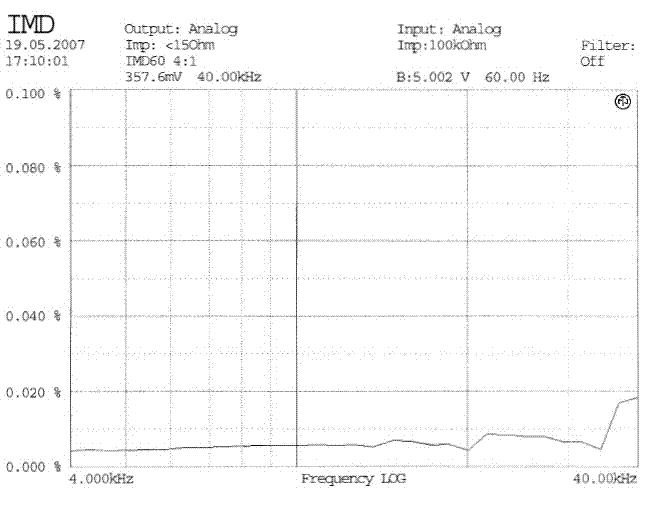

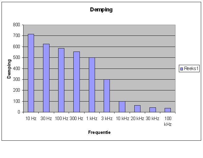

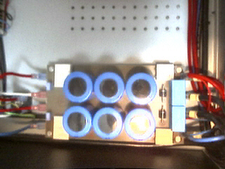

Measurement results Ulti-Amp.
Every now and then i still get questions en e-mails about the Elektor Ulti-Amp. Most of the questions can be answered by reading this tread. As promised to some of the people who have e-mailed me about the measurents i have done on this this amp, here are the results.
