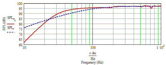

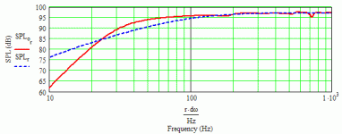

Again, using the horn mouth cavity and width, depth dims of the 846B shown here: http://www.lansingheritage.org/images/altec/plans/1974-enc-design/page22.jpg with a woofer layout same as the 846B, i.e. driver ~up against the inside bottom of the cavity, then assuming 3/4" (19 mm) thick no-void plywood such as 11 or 13 ply Baltec Birch (all dims i.d.):
L = 46.5"
W = 25"
D = 16.5"
vents = (2) 4" dia. with length varying from 0.75" to 5" depending on what works best in-room. I prefer the additional pipe loading that placing the vents near the bottom yields (3" up), but if you think you might ever convert to dual woofers, then placing them midpoint between them is better overall, or 26.25" down from the top. Regardless, place them 3" i.d. in from each side.
WRT bracing, either vertically oriented 'ventilated' plywood panels or 1x3 Douglas Fir (or stiffer) to both tie the parallel walls together as well as support/mass load the driver(s). Regardless of whether you design for the baffle or rear plate to be removable, I recommend industrial Nema 4 or 4x neoprene gasketing in lieu of the typical window sealing foam normally used to seal it.
WRT damping, Altec's standard of one of each parallel wall be covered with 1" acoustic fiberglass is more than enough, so top, back and one side, though rather than actually adding it to the top, making a hanging cradle of insulation that completely encloses the horn area is what I recommend.
I don't have a way to accurately sim how a high output impedance amp combined with the passive's and any wire resistance affects the frequency response and why you may need to experiment with different vent lengths, but it will be much flatter over a wider BW than shown.
The first sim is with 5" long vents positioned below the driver:

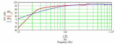

If you're 'sure enough' these will remain single woofer speakers and they sound 'boomy' in-room, then sealing off the horn cavity to reduce the net Vb is an option. 6" vents positioned near the bottom:
