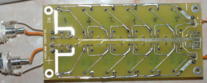

I have just tested a relay attenuator board, and I'm quite diasppointed at the moment. Something I do wrong probably, but I do not know what. If you have any experience with R-2R relay attenuator network, please let me know. If you could point anything wrong on my proto, please let me know.
This is the schematic :

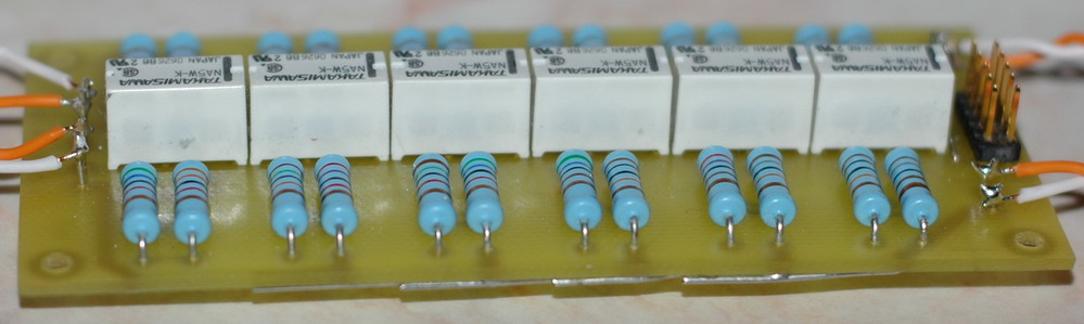

and this is about the bottom :
the resistors are proven 1W Beyschalgs, the relays are Takamisawa NA5W-K. The traces on the PCB are mostly the resistor legs, instead of copper trace.
The board is inserted before a line amplifier which is followed by a 2A3 PSE and AN speakers. The line amp starts with a 100k alps black, turned to full volume. The wires to and from the board are very short, 20-30mm only. The relays are run from 3 alkaline battery BCD encoders. 4.6V measured. It works perfectly on the bench, gives the logaritmic curve very accurately.
The sonic difference is interesting. It looks like to higher the high frequencies a bit. The LP noise is more significant also. Several different disk is tested and on some tracks I did not know which one is better. For sure it was different, much different. Sometime it had a bit more trasnsparent space, but after listeinig it longer I did found it to be true, rather it had too much high frequencies. Brasses decided it, very significantly. The network sounds good, but the alps has much more life, the instrument has more weight.
I was thinking about, maybe I have used wrong relays. I would be very very interested in what relay should I try.

Hi kevinkr, I have very good experience with these Beyschlag resistors, this should not be a problem.
The relays are miniature signal relays, max. 50mOhm is specified contact resistance. It is sealed.
I'm now thinking about to make a "burn in" circuit. The relays are brand new, during the measurements I switched them no more than 30 time each.

I looked up the NA5W-K and despite the bifurcated gold over silver contacts I see that the relay is designed to switch higher currents its high reliability rating not withstanding. I'd change that to a relay designed expressly to switch low voltages at very low currents. Usually the maximum contact voltage rating will be <30V and the current 50mA or less. Alternately you might find reeds better. There are relays in your existing form factor that will pop right in and have the required specs.
I'm no fan of beyschlag resistors, nothing special imo, and not what I would use in this application.
It may well also be that the attenuator is telling you an "inconvenient truth" (love that line 🙂 ) about something else in your system.
Another thought is that there are a lot of contacts in series with the signal in that binary attenuator.

Hi Giordano,
The relays look good to me. I would be happy to recommend them for general audio use. There are auguably better relays but I believe your problem lies elsewhere...
I think the problem may be due to the higher resistance of the relay attenuator interacting with the input capacitance of your amplifier forming a low pass filter that is audible.
You mention the connection to your amp is very short, but coax cable has considerable capacitance even for short lengths.
You could try measuring the input capacitance and lowering the resistor values. As little as 50pF of capacitance could be an audible problem with your high resistance values.

I'm more and more getting to the point that there is an impedance matching problem. In theory it should work, the network is designed for 100k termination, and the alps provides that.
In the other hand, yesterday at my friend's system it was sensitive to noise (mainly from mains) pick up, but we were able to place it with minimum noise. Today I spent 2 hour now on how to place it behind my preamp, but I have so much noise pick up that I can not evaluate it. Unfortunately just behind/under the line amp I have the mains distribution. I know it is not lucky, but I had 0 problem with it so far.
I'm afraid that this network must be right in the tube's legs with it's termination good noise floor.

its really interesting again that all answers so far just deal with ominous component ´qualities´ and no answer dealt with the circuit schem aka the component values itself! Very High-Enderish indeed and most sadly probabely useless
I don´t think, that the chosen resistor types and relays are responsible for the ´bad´ sound. The choosen resistor values are imo the problem. They are way too high! This leads to a too high output resistance value and hence to reduced bandwidth.
I´d suggest to redesign the resistor values so that You have a lowish output resistance. Anything above 2kohms is rather problematic.
The values which You chose after Jos´ attenuator are very high. He works with an output impedance of 22kohms, reducing to ~2kOhms only for the lowest 32 values (those You probabely never need anyway!). This might work with high input impedances within a tube amp, but gives problems, as soon as You have to run the signal through a cable (i.e capacitances). Too the change in output resistance leads to a nonlinear stepping when You don´t run the attenuator into the specified 100kOhms input impedance of the following device (most devices work with 47kOhms).
A general problem of these logarithmic attenuators is that to achieve a high level of step linearity the resistor values have to be very tightly tolerated.

Some have commented that the network values are excessively high, to those individuals I would comment that this is standard practice in tube gear where presumably tube sources have neither the low source impedance nor drive capability of most op-amp based solid state gear.
Note: Several have commented on high frequency roll-off, if you read the original poster's comments you would realize this is not what he is talking about, but rather the reverse. (I mentioned this in an earlier post along with a lot of other things.)
I also use all hand built step attenuators which in this case switch 2 resistor networks, which means I never have more than two resistors or two contacts in the path. Mine are hand built using Holco H4 resistors (the older version) and elma switches which unfortunately are NOT the last word in reliability. I have also used the dact attenuators in some commercial work I did in the past - these also work well. These incidentally have all been 100K types as I want to retain compatibility with tube tuners, tube tape machines, and some of my phono stages which in the past did not have particularly low source impedances.
The suggestion to hardwire with relays removed is a good one - that will either exonerate the relays (unlikely) - I too have had lots of problems with relays in the past -- or not.
I had some problems with mepco-electra mf resistors some years ago, ultimately it turned out that the end terminations were done incorrectly and the resistors in question were generating a lot of distortion. (I measured 0.15% for several of these as opposed to below the tester residual for same value different brand. Circuit was just a simple 6dB attenuator.)
If you have a good pc sound card and audio tester (audiotester.de) software you can have a look at the distortion spectra as well as frequency response anomalies the volume control is introducing at different attenuation settings. At this point I think this is almost a must - eliminating the guess work as to what is going on here. Use a unity gain buffer ahead of the sound card input so you can have a high input impedance. In a pinch the 5532 (dual) will work - better still the AD8610/8620 or the LM4562 (dual) - any will give you distortion levels far below what you are trying to measure.
I do subscribe to the possibility that the attenuator is simply unmasking things that your volume control pot has hidden until now.
I've never heard a transparent volume control pot, and don't use them if I can avoid them. You should remove it from the circuit for evaluative purposes.
I'm surprised.
The relay is the problem. Sure. We selected a comfortable level and soldered the shorted legs together. All the problems disappeared. Significantly. Some elevated treble remained, but it is not a problem any more. It is not too much, just very lightly more. Interestingly, on some disks the alps black won, on some disk the network. I heard the network to be better most. On orchestral music I heard better transparency and better treble.
This means I do not give up 🙂 I try the Omron G6K relays. If it stays the same, I'll build it in. I hope by building it in, close to the tube it will improve further.
In the other hand, if would have started to solve somehow to remote control a rotary switch, I would be in better position with less efforts 🙂, but I'm not good in mechanics at all.
Remote control is a must for us now, our 11 month old baby sleeps on music sometime and to get up, decrease volume and sit down back with her in my hands is not really comfortable, also we listen to music on a decent level, but we should decrease volume easier on high volume parts. That is why I do it all.
http://web.t-online.hu/jordangabor/
