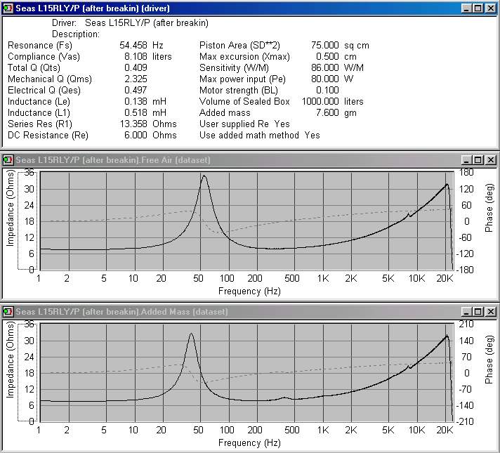

I am using SpeakerWorkshop to measure my drivers via the delta mass method. Problem is estimated Qes and Qms (therefore Qts) are way too low. Vas is also too low for my larger L26 driver.
The two drivers I've measured are a Seas L15 and Seas L26. Both drivers don't appear to have any mechanical issues (ie. no rubbing or scraping noises when driven to excursion) and have been broken in for about 4 hours each using 1/3rd octave warble tone centered on 30Hz with a +/- 10Hz warble offset.
The L15 measurements look reasonable, although Q is too low.

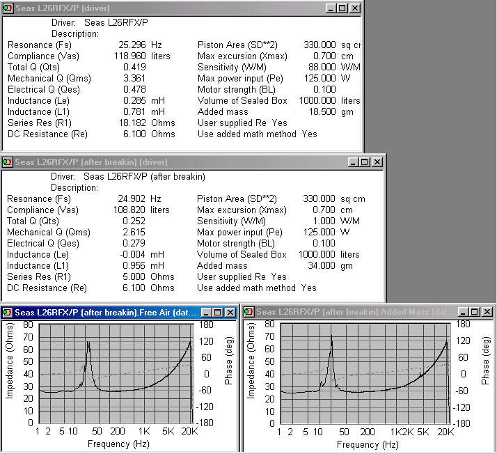

The graph below is the L26. Here's the stats
manufacturer T/S params
Qms = 2.15
Qes = 0.39
Qts = 0.33
Vas = 171 litres
my measured T/S params
Qms = 2.615
Qes = 0.279
Qts = 0.252
Vas = 108 litres
The bottom two impedance curves are Free Air (left) with added mass (right) from the after breakin measurements.
At first I thought the mass I calculated was wrong. Of course a smaller calculated mass than actual used will result in a larger Vas, however I'm using coins with (I assume) reasonably accurate weights. Even if they are off, to get the Vas into the approximate region (ie. 171 Litres for the L26 instead of 108 shown after breakin below), I need to put in about 2/3rd of the actual weight used in the calculation (ie,. I added 36gms of coins so put in about 22 gms into SW to get Vas = 168 litres. The coins simply cannot be that much out).
Any ideas?
Is my breakin period not long enough?
Am I not driving the woofer hard enough to properly breakin? (I doubt it as I believe it is being driven close to its 7mm xmax).
Is it possible to have a Q lower (in my case I believe significantly lower) than the manufacturers after breakin?
You might notice the weight used for before and after breakin differs. I tried doubling the weight after breakin to see if that made a difference, Vas however was still in the low 100s.

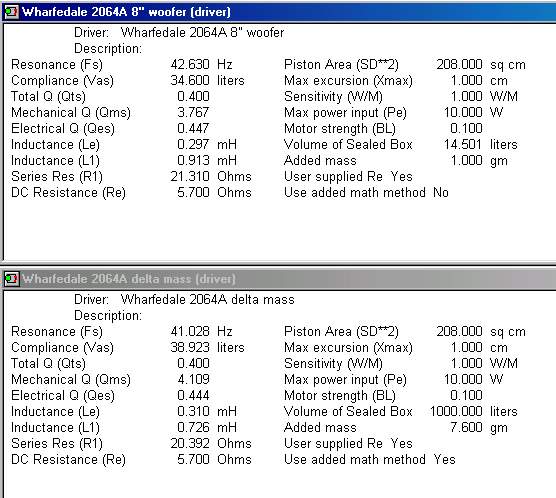

Ok, maybe I am being paranoid, or my Vas accuracy goes down with increasing driver Vas.
Here for example is an 8" woofer. First set of T/S params are delta compliance measured in a 14.5 litre box. The second are delta mass with 7.6 grams added.
Vas in both cases is pretty similar

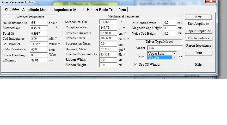

Hi oldbar,
Yes thanks to posting your T/S params. That would be helpful.
I did get a 144 litre Vas at one point, but that was a one off, while hand holding the driver. I threw the measurements away thinking it was an erroneous measurement.
Out of interest, could you please post a little about your project with the L26, especially your enclosure type and xo point and low pass slope for the L26.
David.
Hi Oldbar,
I also notice your Q and Fs are in the same region as mine.
I think your Vas is artificially high. Your effective area is 397cm2 - when the L26 is actually 330cm2 (you have to remove the phase plug area from the overall cone area measurement). This would result in an inflated Vas calculation.
For example - if I set my Sd to 397cm2 - I get Vas = 166 litres (not 115).
David.

In soundeasy from what I understand the effective diameter is measured from about 1/3 of the rubber surround and that is is entered into soundeasy when you do the TS parameters.
The effective area is what Soundeasy calculates when it is doing the TS parameters.
You now have me wondering if I am doing something wrong myself but i have checked on Zaphs website to compare the L18 and my measurements are like his.
Hi oldbar,
I think Soundeasy will only be able to calculate effective area from the diameter or radius you enter. Unless I am completely wrong, I believe you have to account for the phase plug and subtract that from your cone area. you would then fudge soundeasy by giving it a diameter (or radius) so it derives the same area (unless soundeasy allows you to enter phase plug radius / diameter as well).
For example, the L26 cone diameter from inner edge to outer edge surround is 210mm. The phase plug diameter is approx 46mm. Subtract the phase plug area from the overall area and you get approx 329.5 cm2 (seas posts 330cm2). I don't have an L18 to measure diameter so can't tell whether Zaph took that into account for the L18. His calculated Sd is however 6 cm2 larger than Seas quoted (132cm2 vs. 126cm2).
David.

I think you take the dust cap into account because it is part of the piston moving air (ie. attached to the cone - not the former). In the case of a phase plug - it is fixed and therefore not contributing to the air movement, therefore not counting as part of the cone (piston).

I was just wondering how did you go when you measured your second driver.
I redid my measurements for the L26 and ended up very close to your vas taking in to account the phase plug.
If you like I will posts mine later on this afternoon.
