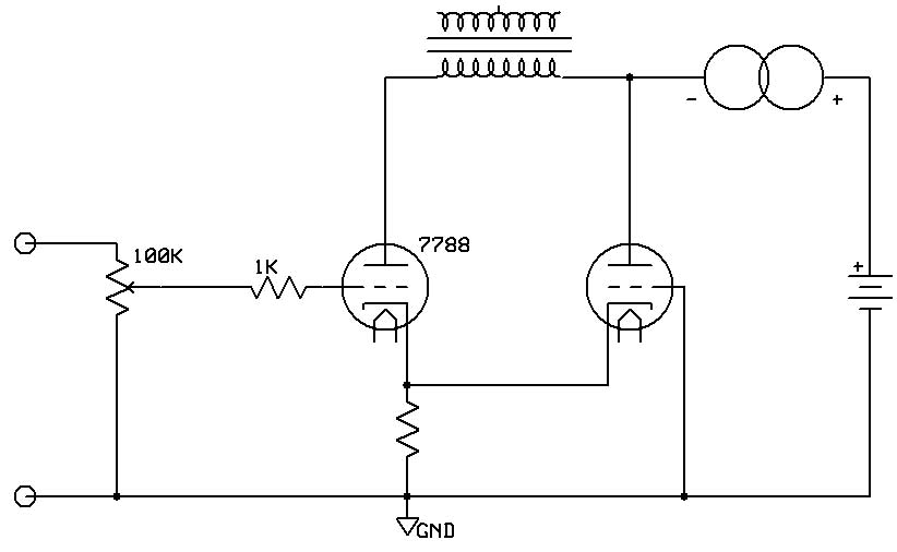

Maybe this will help think about this -- this circuit should work the same. In fact, maybe it will work better and I should just do this instead. I have not figured out what the second tube should be yet. It could just be the same tube, but I don't see why it would need to be ... on the other hand, have I just drawn up a primitive push-pull amp with single ended iron?
