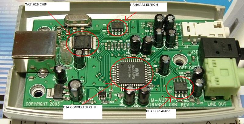

Ok, I have the parts to start with (got the cdp for nothing with cold solder joints on the regs), but not much experience with delicate digital stuff, will report as I progress through.
M-audio transit in the attachment
The marantz has TDA1541A and SAA7220 so it should be pretty straightforward.
Could you please give me your ideas? Mine are remove the DAC from the transit, remove link to 7220 on the CDP, connect I2s lines with a short ribbon cable, make sure the ground is same on the transit and the CDP.
So from the place of the AK4584 tap the following:
Audio Serial Input - SDTI
Audio Serial IO Clock - BICK
Channel Clock - LRCK
to the corresponding pins of TDA1541A
bit clock input - BCK
WS - word select
Data Left - DATA
So LRCK -> BCK
BICK -> WS
SDTI -> DATA
is this ok?

lucpes said:
Another variant which I think is correct:
Serial must be data (SDTI goes to DATA)
Serial Clock must be bit clock input (BICK goes to BCK)
LRCK goes to WS.
Well, got it all figured out 😀 Sound is unbelievable compared to the actual cd playing or the soundcard itself.
Well, in I2s mode the TAS1020A puts out:
CSYNC->LRCK (WS)
CSLK->SCLK (BCK)
CDAT0->SDOUT1 (DATA)
These go to pins 1 2 3 of TDA1541
Remove the small smd resistors to the DAC and the 3.3 V regulator to disable the rest of the card. It's very easy to figure out which goes where if you read the datasheet for TAS1020 I2s mode 1.
Anybody knows of a way to temporarily disable the 7220? I kinda don't need it anymore 😀
