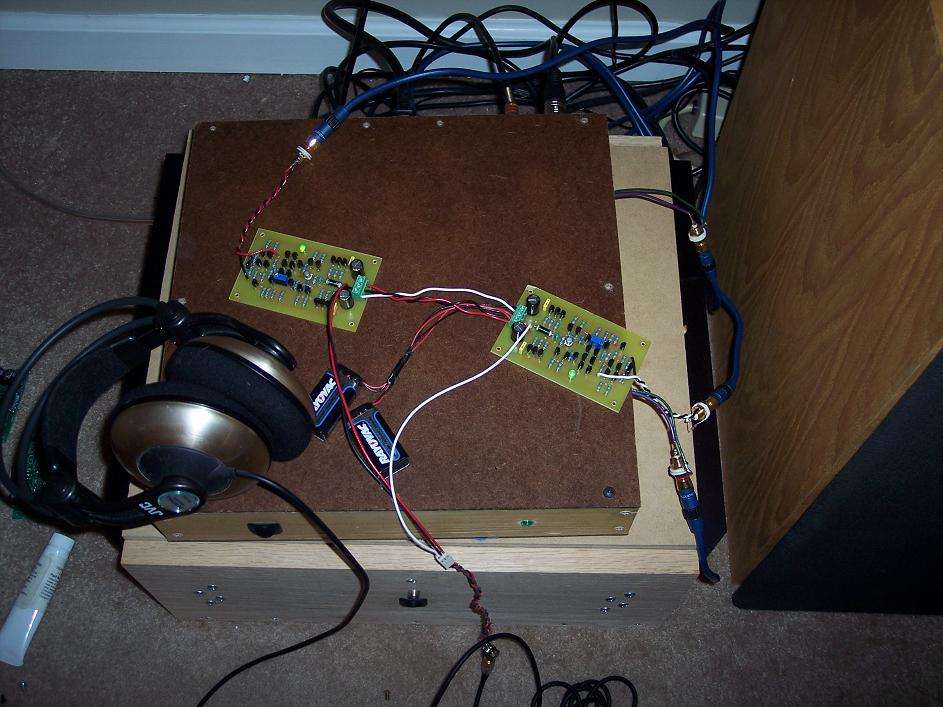

Here is a picture of a prototype (slightly different CCS) in use. Special thanks to Brian Donegan who etched stuffed the first boards and encouraged me to finish the project.

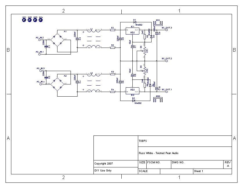

I have been using my LCBPS (Low Current Bipolar Supply) dedsign to power the circuit. But you could easily use batteries, or even an unregulated supply. The PSRR of the amp is good, so it will not be very picky.
Here is the schematic for the PS I am using:
The VREGs are LM317/337.
