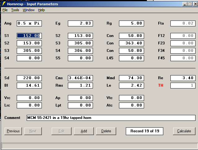

Well I don't want to build junk, so I did a bit of redesigning. I still want to keep it simple, but integrated a taper by putting the center panel a bit off center. This basically creates two sides of the pipe, one that's double the size of the other.
Voila! Two to one taper.
I also found that Home Depot and Lowes have Sonotubes that are 9.5" in diameter. That's what I'm using instead of ten inch. The reduction in diameter flattens out the response further, since these MCM woofers really want a small box.
Parameters attached.

Patrick Bateman said:
The resistor flattens out the response quite a bit by raising the QTS of the woofer. (A higher QTS requires a bigger box or horn.)
Yeah, there's 'no replacement for displacement' down low and it takes a minimum box size for a given ~flat gain BW, so either Vas or Qts must go up to 'fill' it if you want it ~flat, with increasing the latter being the easiest for the DIYer.
Thanks for the heads up.
You're welcome!
I didn't mean to scare you off as I don't see anything fundamentally wrong with the TP concept and apparently the math doesn't either according to Hornresp, just that Al's build highlights how sensitive to variables any tapped pipe/horn build can be and unfortunately he hasn't let us know where his might have gone awry.
I'm still probably up to at least a year away before I'll be set up to build/measure again, so was hoping someone in the meantime would give these a shot since they are so cheap/simple to build.
If I'm understanding you, the baffle is just made narrower and offset to create a stepped pipe rather than the tapered one simmed, so it will be interesting to see how it measures Vs the sim.
Anyway, thanks for sharing as so far outside the few on the TH thread that have taken the 'plunge', folks I've suggested THs to have proven way too intimidated by such simple box builds once one or more internal angled boards are added. 🙁
