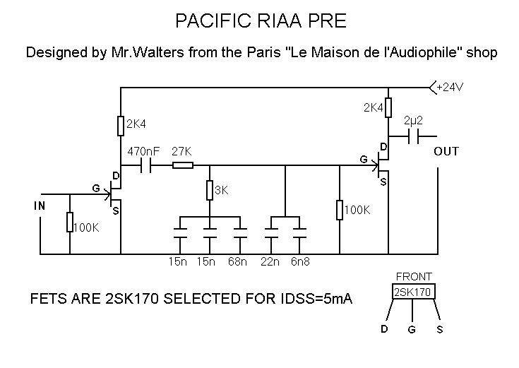

I find myself in need of a phono preamp. I've looked around and it seems that I can find designs based on unobtainium components or designs based on opamps. Maybe I shouldn't be concerned about it, but I would like the first stage, at the least, to be discrete. Can anyone point me to designs that use readily available parts?
If not, anyone want to take a stab at designing one? Unfortunately, I'm not knowledgeable enough to do so on my own.
Whatever solution I settle on will need to work with average output moving coils (0.5 mv) and not be too expensive.
Thanks.

There's Norm Thagard's design in audioXpress, Jan-Feb 2001.
JFETs: 2SK389, 2SJ109
BJTs: LS352, LS312, MPS6523, MPS6521
I thought about building this design, but decided to go with an op-amp based one (ESP) for the sake of simplicity. I haven't done the research, but if the original parts aren't available, there's probably compatible ones with higher noise specs. Or with some redesign, it should be possible to adapt the concept for all-BJTs.

In the LP797 the hard to find duel J-fet appears to have both devices in parallel. Couldn't one just replace the pair with a single low noise J-fet and re-bias for that particular transistor?:scratch:
You can use a matched SK170 pair -- mount in close proximity -- you can epoxy them together or use a tie-rap. I believe that Linear Systems will sell small quantities of the LSK389. The pair of '170's knocks the noise down (it is already very low).
The high gain JFET's also are somewhat high capacitance...
I don't particularly like the AD797's in this application.
Here's the Maison Pacific simmed with Linear Systems model for the LSK170 -- and some changes to the capacitor values. note that the deviation in the lower chart is +- 1dB -- this is only a sim, I haven't breadboarded the device yet.

I have some discrete designs based on the low noise Hitachi (now Renesas) bipolars. In the UK, you can buy these from Farnell or Dalbani, and I guess other mainstream suppliers will have them too.
For MC inputs, these bipolars are attractive, as they have a very low 1/f noise corner frequency. Although the white noise of the best FETs, run with enough current, is pretty good, all the ones I have seen have much worse 1/f noise than a bipolar.
In a flat frequency response amp, 1/f noise doesn't matter much, as the ear is not sensitive to quiet low frequency sounds. But the RIAA curve adds 20dB of bass boost, and 1/f can matter.

PNP 2SA1084 (or higher voltage version 2SA1085)
NPN 2SC2546 (or higher voltage version 2SC2547)
HFE linearity is very good - basically constant between 0.5mA and 15mA. If you run them with Ic of about 3mA white noise is equivalent to a 20Ohm resistor!
They are fast enough (120MHz) that there is no problem.
They also have very high HFE values - the E selection is in the 400 to 800 range. This brings the base current down, and hence reduces current noise, so a single input stage will run optimally over a reasonably wide range of source impedances.
