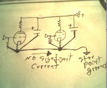

I am trying to see what you mean about ground-return current, but a buss ground and a star ground with a reference bus are completely different.
Let's say you have a copper conductor with one end attatched to the main ground reference point: If one has a ground node (say the ground for a particular stage's capacitor) and all the grounds of the stage that capacitor feeds are tied directly to that node: there is the current loop. Then you have to reference that node to whatever voltage you are calling your reference-- zero or otherwise. The reference connector is not a part of the current loop, and that connection from the node to the reference is not a current-carrying conductor, so how can you have an issue there as long as every stage is a contained loop and there is no current along the (voltage... not current) reference bus?
here is a grossly simplified example of what I am asking:
If there really were "no significant current", then there would be no significant problem.
I'm not sure I understand your diagram. How is the current from the B+ supply getting back to the supply's ground? Anyway, at least the noise and variations of the B+ supply would cause current to flow through the capacitors, and then the buss, to the star point. I think I would want to also test it with at least the grid input resistors having their own separate ground references.
Personally, I think it would probably be good to try to use a "star power" topology, too, along with a star ground, and keep the power and corresponding ground conductors together, tightly twisting together each power feed wire and the ground return wire for it (and also twisting together reference-ground wires with the signal's wire for which they are the reference, if possible), if using point-to-point wiring, or running the PCB traces right on top of each other, on opposite sides of the board, if using a 2-sided DIY pcb. That should all also help in trying to keep the loop areas as small as possible, which should help to minimize field-induced currents.
