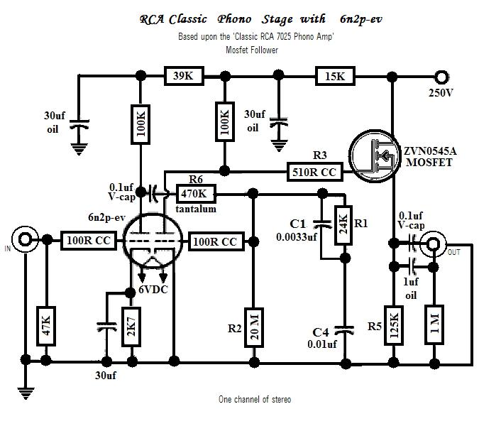

The cartridges to be used are a Shure M97xe on a Linn Axis, Shure M95ed and M75ed-t2 and Ortofon OM20 on a couple of lesser turntables. Topology I prefer would be probably classic two stages or two stage with follower like the RCA circuit in the back of the tube manual. I prefer simple to complex, where possible, in all things. I know that some things are too simple for their own good so I don't want that either.
No input transformer. Directly driven from the MM cartridge.
I want to build a (phono) preamp with the benefit of other peoples experience so I'm not just blindly copying the circuit and sound from an old integrated amp or receiver, unless, of course, there is some truly exceptional one that I need to know about.

The weaknesses of the "classic" RCA circuit are mediocre bass extension and miserable drive capability. Those problems can be addressed easily enough. A tweaked RCA circuit schematic is attached. A plus frequently overlooked about the 'X7 is the availability of a FINE tube, the Sovtek 12AX7LPS. Specimens of the Russian tube, with a superior noise factor, are available at modest cost. Add a nice, "uncolored", tone and the selection nears being a "no brainer". 😉

MMs in general, and Shures in particular, are fussy about their loading. If you use a high mu tube at the input, you'll have a very high input capacitance because of the Miller effect. For high mu tubes like 12AX7, trioded D3a, 6SL7, and the like, the input capacitance will run 300pF or more. With reasonably achievable values of cable capacitance, the cartridge will not be happy and the frequency response will look like a roller coaster, but you'll be able to tell everyone you know that 6SL7s sound squawky.
You then have three choices:
1. A lower mu input tube, but the need for two more gain stages.
2. A tube cascode
3. A hybrid cascode with a FET on the bottom
If I were to do one of these three today for a publishable design, I'd probably use an ECC88 variant, just because I know them so well and they're easy to find and inexpensive. Another choice, highly recommended by two guys I trust (and thanks for the tubes, fellas!) is the 6AQ4, and I'll probably end up using that in the one I'm starting next.
FWIW, my last phono preamp, which I used for over 20 years, went with approach 3, using an E88CC variant on top and an NTE458 on the bottom.
And purely IMO, but with some objective reasons, there is not a single "classic" phono stage that's worth a warm bucket of spit.
