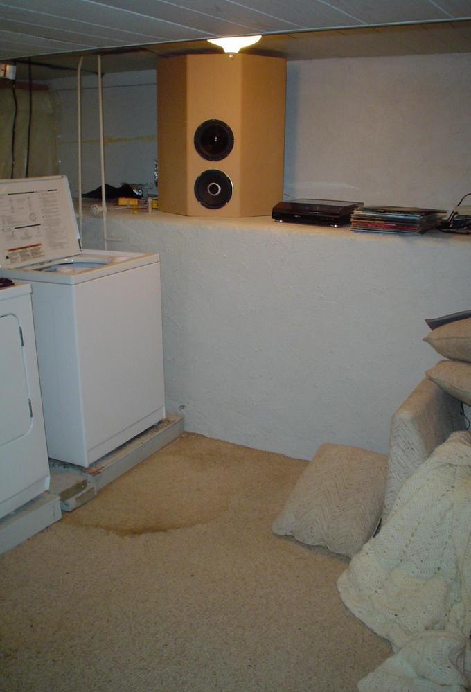

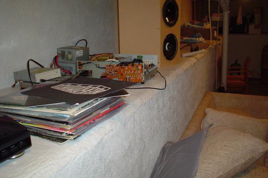

That looks nice GM. You would have a pretty wide, but not very deep box with that. You wouldn't necessarily need BSC with that up against the wall. I think if I have the time and money, I will try both.
This is what I am working with for a room. The pony wall is 29 inches deep and 46 inches tall. The roof is 80 inches from the floor.

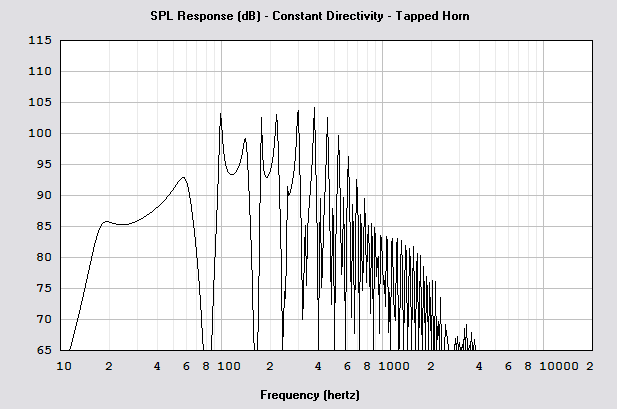

FWIW, here's one B20 tapped horn I simmed:
GM

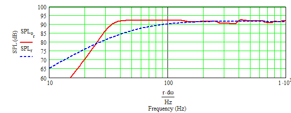

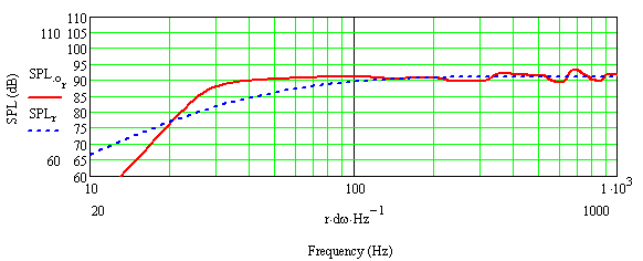

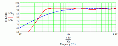

Man do you guys subscribe to "bigger is better"!!! How about trying more WAF-friendly dims of:
L=28" with a cross-sectional area of 9.5 x 14 in
Driver - 5" down from the top
Stuffing density = 0.25 lbs/ft3
(entire cab stuffed for a total of 0.539 lbs)
Port = Parts Express 260-404 Port Tube 3" ID x 4-1/2" L
located 4 in up from the bottom.
Using MJ King's MathCad worksheet:
When I model the in-room SPL response of either, the curves are different but there's no clear winner. Both go as deep and are equally as sensitive. Its really a case of what you'd like your peaks & nulls to look like from 200 Hz to 1 KHz. Most of the differences there are probably attributable to the different heights the B20 is up from the floor.
The blue curve is for GM's, the red dotted curve is my suggestion. Both cabs are placed within 1 in of the back wall. Both perform better away from the wall but I doubt anyone would want to pull GM's "B20 Monolith" too far away from a wall!
It looks like various different sizes will work but all will probably need tuned to work properly in my given situation. I want to keep it against the wall because floor space is at a premium down there. If I were to guess, I would say the opposite fronts of the pony walls are ~8-9 feet apart, so having them against the wall would help tremendously for me. Would I just need to make a high pass filter that will cut down the peak on the low end for yours GM, or will I need a notch filter to bring it down. This would help with excursion of the driver I would think on the low end, having to reduce the signal to the speaker to get flatter bass I mean.
Holdent, have you tried the MLTL you have shown or did you just whip that up now? I noticed that what you said for the width and depth is getting close to the golden ratio. Does it help the sound any to keep the width/depth measurements close or on the golden ratio?
I should probably get MJKs sheets and fool around with one. I would like to build it ~48 inches tall so that it makes it easier for cutting the panels out of a 4x8 sheet. Anybody see a problem with that?
