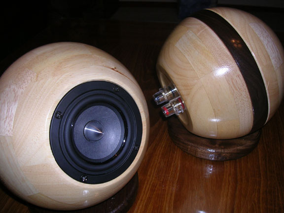

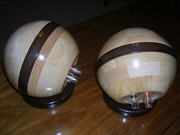

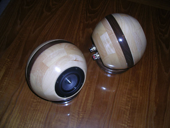

Hey guys,
Just wanted to show off the latest project. Had the idea for a while but finally found what I needed to make it happen plus a little motivation from an earlier thread where one of you guys made speaker enclosures out of bowls found at Target.
So I needed some computer speakers and made this. I found 7" salad bowls at Bed, Bath, and Beyond store. They came in a set of four and all about the same size. I added a spacer to make them evenly round and added some cotton fill inside. The drivers are Tang Bang 3" bamboo. Also made a wooden donut for the base so they can be positioned at any angle needed.
Got to tell you they surprised me. A little 3" driver and it kept up with all kinds of music I put through them. I am running them on a Harmon Kardon receiver for right now. They sound smooth and not fatiguing at all. I listened to them at work all day. Actually I was thinking of making three more and trying them out as an HT setup. So what do you guys think? Any ideas to improve on the enclosure?

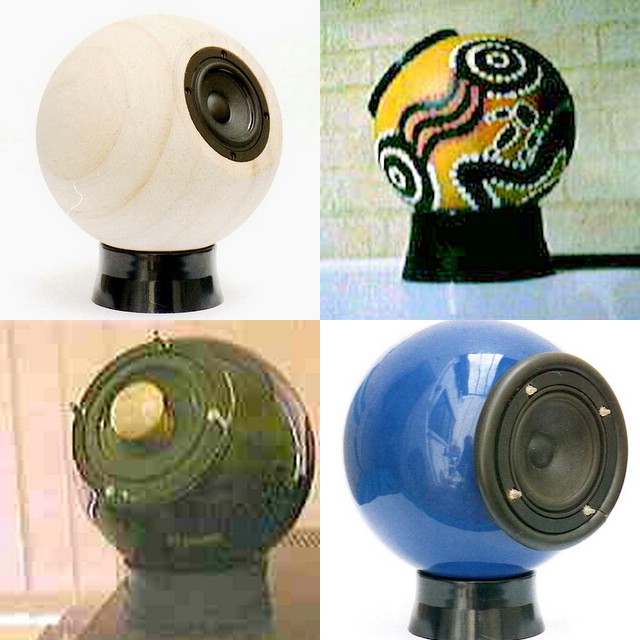

You have just done what I have been
thinking of for X years Very nice
and I am sure the Bamboo units work
well. I use counterweights in a foam
core for balance as I used non Neo
Tang Band drivers. Have seen similar
sorts of bowls in Ikea. Picture is
of my sphere experiments in Paulownia,
Acrylic and Ceramic. Your idea is less
work than mine were. I like it Congrats!

Thanks, I used a lathe. There is a special adapter for a lathe chuck that holds bowls on the outside rim so you can finish off the bottom. So I used a holesaw to cut most of the opening for the speaker and then turned it down to the diameter of the speaker. Once I had the opening I used a flat chisel on the lathe to create the rebate. Trial and error until everything fit right.

Those are beautiful! Those materials would be a lot harder to work with. So how do they sound, especially the ceramic ones? Is there a ring to them or are they dead quiet? It would be a fun experiment to compare all those and wooden ones also with the same drivers to see how the sound differs.

The ceramic Spheres had weighted foam cores
and were lined with tar based spray plus rock wool
to deaden them. The blue sphere is made
of Stoneware and takes a long time to drill
holes in.The driver in the Blue sphere is
an Axon/Haes 4SF-01 with a fibre glass cone
Nylon bolts were used with a blu-tak putty
to secure it to the sphere. Till others
dropped them and I had to make more they
sounded very nice especially with a 6th order
bandpass sub I made. Imaging was very nice.
Did not have my Clio system to measure them then!
I am making some new ones at present. The 3inch
drivers I used are TB 517s & 319s also a Response
3 in coated paper driver from Jaycar which I
always liked. Most are in Acrylic spheres.

Thanks, but to let you know the build was not that bad. If you have a lathe then it makes it easier. But once you start going bigger most affordable lathes are only a 12" swing. So probably the biggest bowl you can put on there would be a 11" or so. Unless the lathe head swivels than you are limited only by the clamp that holds the work.
I was also thinking how to do it with a router and a circle jig. I was going to make a clamp/ jig to hold the bowl. A square piece of plywood on the bottom, 4 threaded rods one in each corner, and then two pieces of plywood on the top. Using a circle jig with the router the lower top piece would have a hole cut out that was larger than the bottom of the bowl so it could center it. The top piece of plywood would have a hole cut out that would be the correct size for the driver mounting and then one more piece of plywood that would be the correct size for the rebate. The router would have a bushing that would follow the hole cutouts and the bit would cut the bowl. It would just take some measuring to figure out the correct hole sizes with respect to the bushing and router bit diameter. That should do the trick.

A hole saw??? That is too easy. I guess you can use one of those also. Then use a router bit with one of those bearing kits so you can adjust the amount of material removed for the rebate or you can forget the rebate all together.
The circular spacer was made with a circle jig and a router. I have the Jasper JIG and it works nicely because the holes are in 1/16" increments. All I did was cut the outside of the donut a little bigger than the bowl diameter. The inside I tried to cut as close to the inside diameter as possible. Once I glued everything together I chucked the whole enclosure into the lathe and used a chisel to round it down to the shape of the bowls. A little sanding and that's it.
