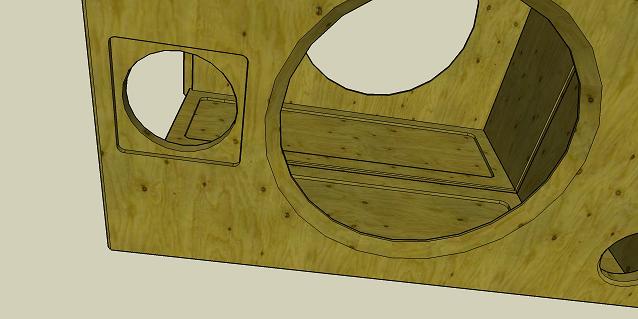

hi there, i thought id better start a new thread rather than jacking Saturnus's Boominator thread. im planning on building a replica boombox from wood or some other suitable material. following V-bros advice im going to build one from scratch. this is the model im copying, its basically a pretty simple shape
the big one -
ill take off the adornments from the original radio (chrome, stickers etc.) and fix them onto the copy. i intend it looking identical, but want it to sound better. im getting no bass with the plastic.
weight is critical. i cant stress that enough. the whole thing has to be as close to 8kg as i can get it. (i dont have a car!) so the amp32 and 41hz series are a real blessing for me. i bought the killer drivers for this project, 1.5kg and 99db, im in love. - http://www.musicgear4u.com/bass-gui...l10150-neo.html
the big one -
so id like advice, on what type of wood to go for? probably plywood ill go for, im tempted to go as thin as possible, quarter inch, and brace it. but im open to advice or suggestions. the bbx is huge, id say about 36lt.

so far ive been advised to go for a minimum 1/2 inch plywood, but given the size of
the radio (33 1/2" wide, 18" tall, 8"deep) it would be to heavy to carry.
also recommended which im currently looking into ->
*Seems that some sort of high tech sandwich material would be best.
Like epoxy and carbon fiber/glass skin with foam or hexagonal cell or balsa core. Not cheap but I'll bet you can get sheets of stuff like that somewhere.. maybe 1/2" thick. Boats and airplanes use it.. Celestion used the stuff with metal skin for the SL6 speakers I believe..

You might consider a cheaper sandwich material like Gatorfoam. Not sure if it's available where you are, but I'm guessing it should be--try an art supply store. For how light it is, it's unbelievably strong.
It will be well-suited to larger, flat areas, and not for things like speaker cutouts, Still maybe for the back and some of the sides, it'll save you a bunch of weight compared to any kind of wood product. Gluing is probably going to better with it than mechanical fasteners.
For my boombox, I used fiberglas/carbonfiber/nomex aerospace panel scrap I got on ebay. No lighter than plywood, but you could just about drive a tank over the stiff.

The Gatorfoam is amazingly rigid for how light and cheap it is. I made my boombox prototype out of two layers of plain old Foam-Core, and even that sounded pretty good. If you wanted a little extra strength, you could use two layers of 1/4" Gatorfoam laminated together with urethane caulk, which has great damping properties as a bonus. Two layers means more stuff to cut, but if you do it right, you can stagger the sizes of the sheets (the equivalent of a rabbet joint in woodworking) so the inside panels are smaller than the outside, and then you have this stairstep joint that glues up a lot stronger than just two plain pieces, plus leaves less of the soft foamy middle exposed.
Another material to consider as part of this project is modelmakers styrene (or ABS). You can get it wherever model railroad supplies are sold. It comes in a variety of thicknesses, and would be great for adding little ribs and other details to mimic the original mold of the box you're copying. Also for reinforcing edges and corners. Cuts by scoring w/an X-acto and snapping. Paints well and glues up very strong w/cyanoacrylate (Superglue) or model airplane cement, and should glue well to the Gatorfoam. I also use it for subchassis parts inside, to hold boards, caps, batteries, etc. By gluing together lots of parts and pieces, and drilling, tapping, etc., you really can make the same kind of internal structures that are found in the boxes you're copying. The benefit is that you can put things together very compactly, saving space for the resonant chamber you need for the speakers.

thats a big one, the resonant chamber. ive never approached anything like this before. i know i can build it, im just not sure about the math. math scares me! ive emailed celestion about the recommended enclosure volume for the woofer. im looking forward to getting this right.
just got this back from celestion, very nice of them
A suitable size for the BL10 is 25 litres tuned to 60Hz using a vent
with diameter 63mm and length 60mm. 25litres gives you a good compromise
between bottom end and portability.

Hi Ned,
Looks like a really nice project. Did you damp the back of the box at all or did it work ok without?
Also notice that you have been using the best DIY audio improvement gadget of all time - several bottles of red wine 🙂

hi Gfiandy, thanks, yeah, been acquiring a taste for the stuff lately. nice! dampnening material... no, not as yet. to be honest to my *humble, untrained* ears, it sounds unbelievable, i cant get over it. But, ! theres always room for improvement. could you suggest anything that would be lightweight?
Anything that will break up resonance in the panels should help. I have used thin aluminium sheet 0.3mm - 0.5mm bonded on with a lossy glue - something like bathroom sealant would do. You don't need to cover the panel a few small sections will do fine. But if you don't have a resonance problem it may not make a noticable difference.
A bit of loose baff wadding (sort of fake wool) in the enclosure may help as well as this absorbs energy from the air in the box. However don't go mad as too much can make the speaker sound sort of constricted and muffled. You can normally get this from car audio shops.

I would look at trying to fill those little grid spaces on the back of the plastic front panel with some type of foam glue. I'm thinking of some kind of urethane-based product. In the US, we have "Gorilla Glue," but I don't know what the comparable products over there would be. That ought to stiffen it up a lot, especially if you incorporate some lightweight stiffener bars/panels to strengthen places where the plastic is weak from openings, etc.

I should have also mentioned that the flat areas (like the bottom and sides) would be stiffened a lot by gluing on a layer of modelmakers plywood of a few mm thick. There are also resonance-absorbing vinyl or asphalt sheets meant for car autio use. These can be fairly heavy, though.
