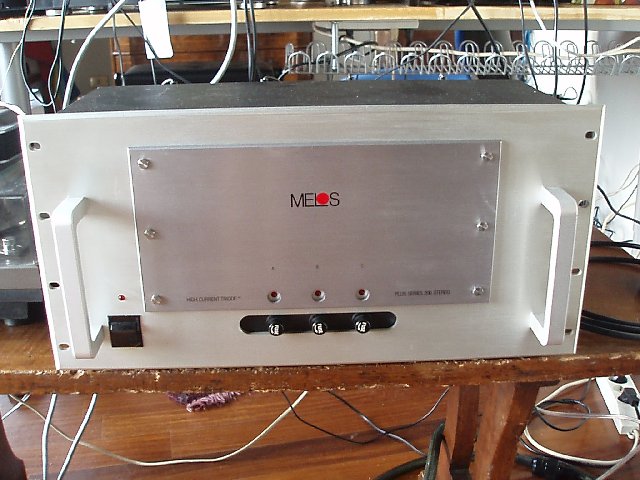

I own a Melos triode 200 plus stero and I have problemas with one output (noises and distorsions) and when the problems began the powamp produce a terrible burning smell. It seems a transistor burning smell.

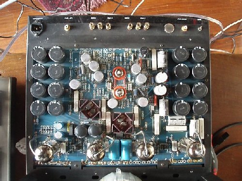

This is the amp we are talking about

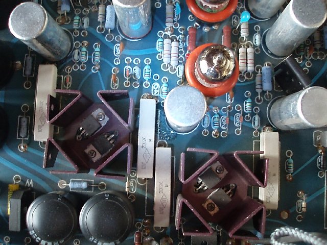

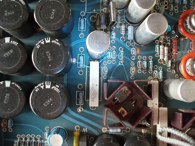

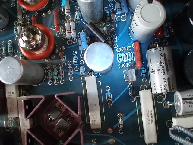

If the ouptup problem born from that, and anyway, the schematic would be very useful to understand what is happening and how this capacitors or the oil patches can be connected with the transistor burning smell.

And this is the back opened with the pcb
On the front left side there appear to be two capacitors with bulging tops which might indicate that they are failing and about to vent. The metal tops underneath the plastic insulating disks should be completely flat if they are not failing. Replace with higher voltage/ higher temperature parts if this is the case.

<On the front left side there appear to be two capacitors with bulging tops which might indicate that they are failing and about to vent.>
You have excellent eyes!
Roberto, electrolytics smell bad when they are on the verge of venting. The two caps could well be the offenders. Hope you have verified this and the amp is back in operation by now. I am sure you'd check out other caps as well.

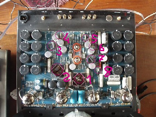

In this moment we are trying to understand what transistors are the one marked in the follow pic, because Melos Audio deleted all the specifics on them.
There are 2 in the circles marked 1 and 2, and 1 in the circles marked 3,4,5,6,7,8.
Thanks to everybody help us.
